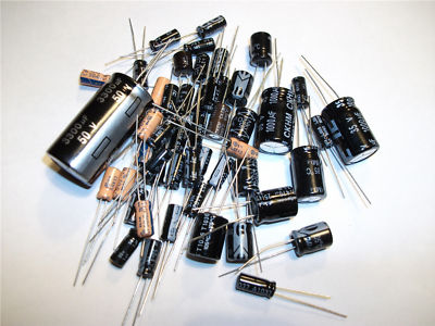

Sounds like a typical eBay listing pitch ... until you get it home and open it up. What you are seeing is 30 year old electrolytics in action ... leaking action that is. You will need to take it to your local tech and have them replace all the electrolytics in the unit. Expect to pay $75-100 for this service. Or, you can purchase one of my kits and do it yourself if you have the chops to do so.
