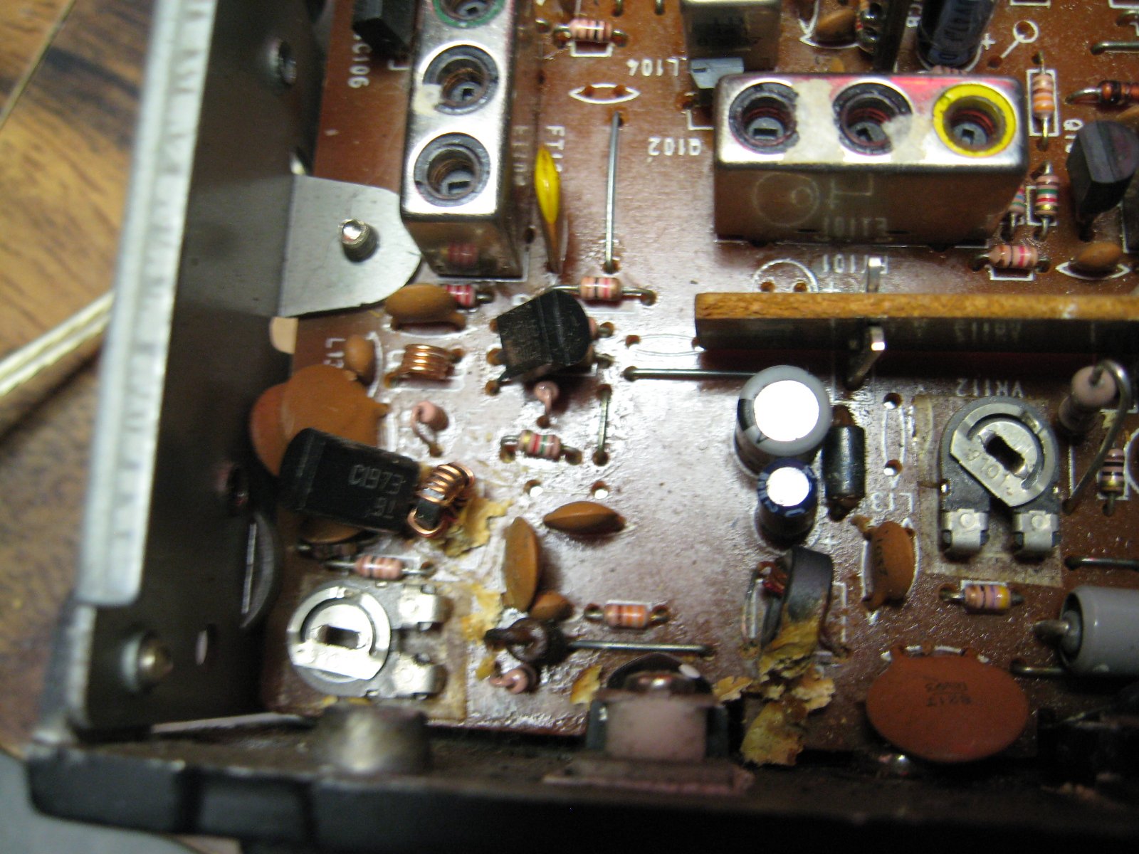

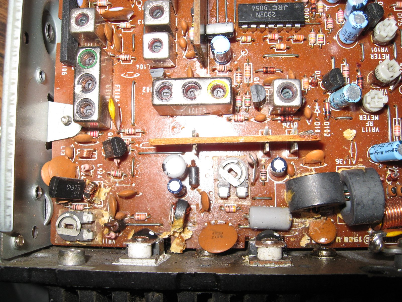

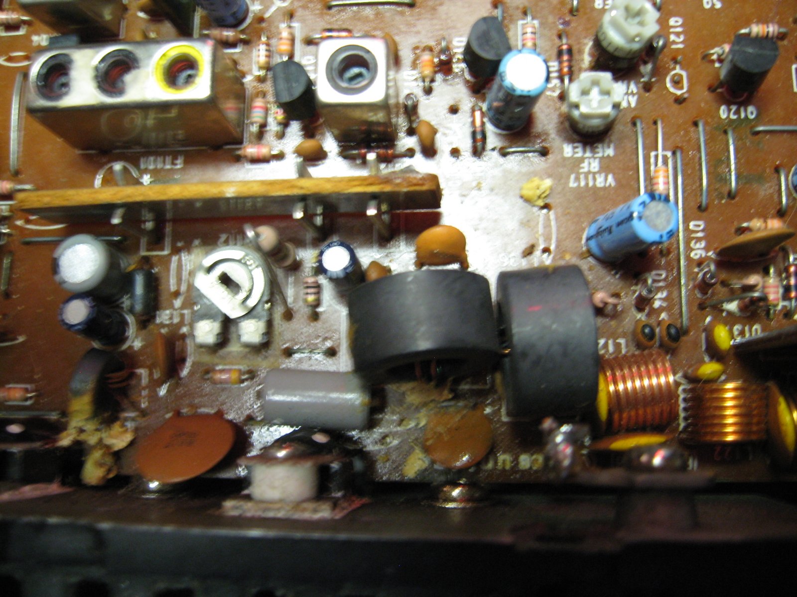

See the below quote from Rogerbird
Cure for High SWR with covers off or on
Usually this problem is caused by the fact that Uniden did not install an insulator between the MRF477 Final and the heatsink.
The mounting tab of the MRF477 (and MRF497) is 'Power' Ground and the heatsink is 'Chassi' Ground.
Meeting through the final can cause a 'RF ground loop effect' which tends to cause the High SWR issue.
The cure is to add an insulator between the Final and heatsink. Be sure to add a thin coat of Thermal Grease to both sides of the insulator.
