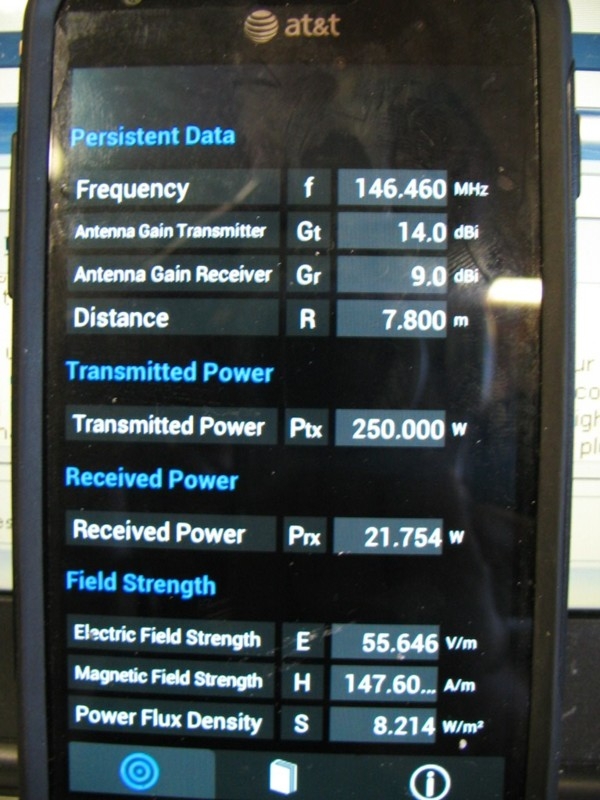

"Field Strength & Power Estimator" is a free smart phone app that I've used quite a bit in an effort to "compete".
By plotting distances in Google Earth, you can plug in numbers and see how much of your signal is actually making it to the receive antenna. This software assumes that you've got line of site between the antennas, so there is no input field for antenna height. However, seeing how much of your signal is actually making it to the receive antenna is quite interesting by changing antenna gain factors, watts out, etc...
