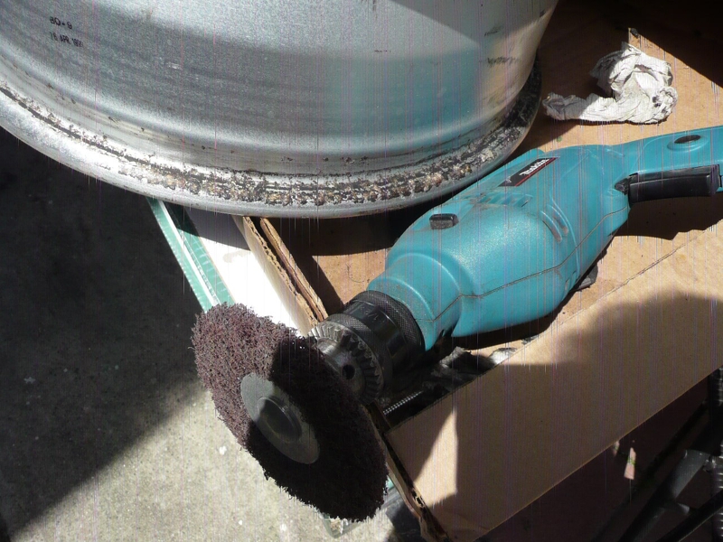

Cleaned the crud from inner lips and brake dust that was everywhere else

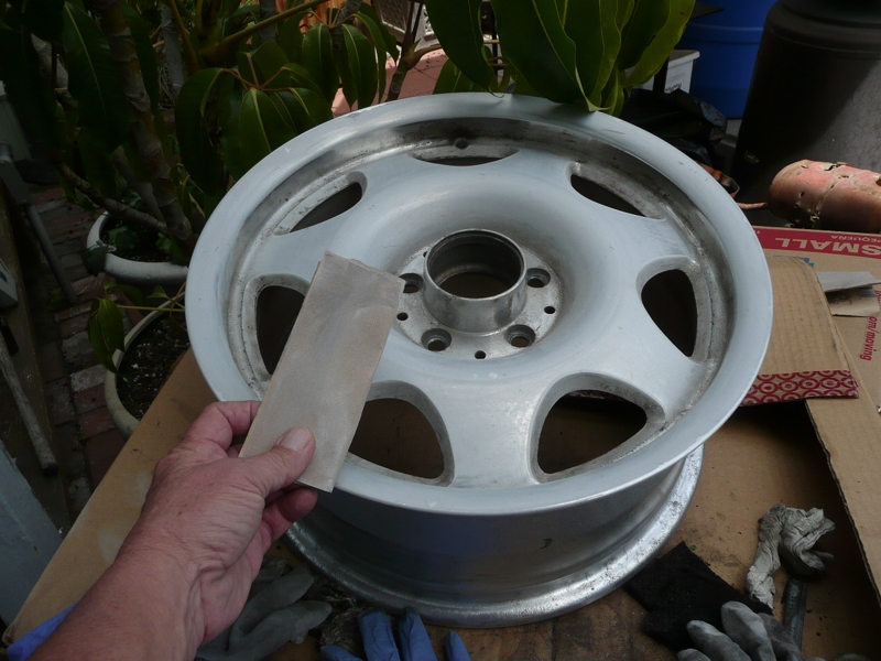

Treated curb rash and feathered out scratches and flaking in the OEM clear coat

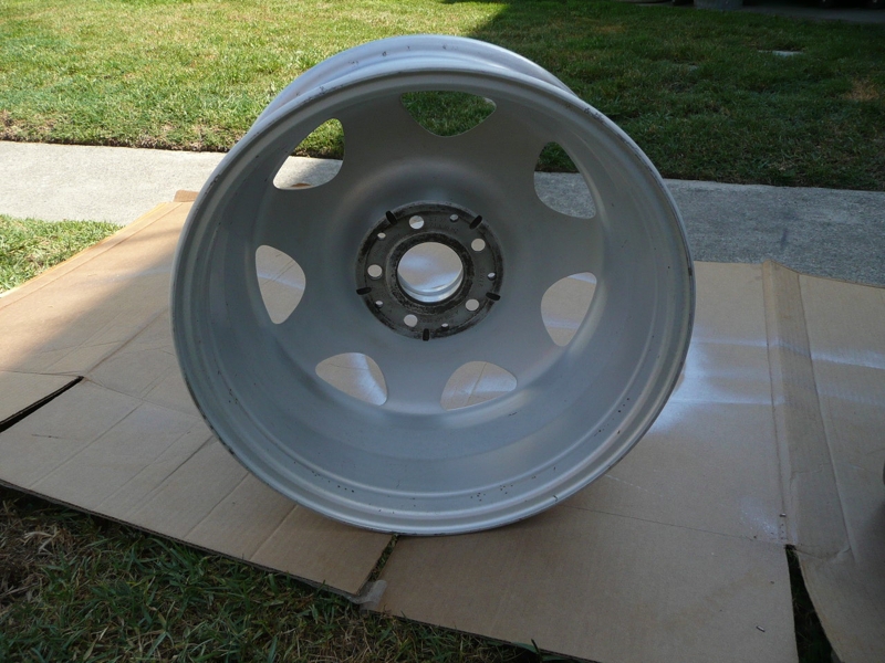

... and painted to match the other two
