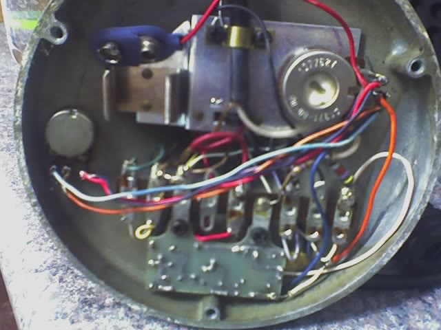

Have not had a chance to open it up but it is a knob where they have indented reference marks into the base. It turns like a gain or volume or something.
Gimme a bit and I take a picture of its insides...
some stuff has been altered, looks like someone already put a resistor inline with the audio lead for better matching. looks like there is anothe resistor inline but i cant tell its so blurry and i can clear it up anymore. do you see a little capacitor anywhere?
I don't see one... but could be wrong. Had to snap that and then go to a Birthday party. Will look it over closer and see if I can get a clearer picture. I forgot and left my good digi cam at work Friday.
Also talked to Russ at R&R communications about it and he was saying he doubted it would need any coversion to work as some of you have also suggested.
I guess I can mike test it with this RCI2980 radio eh? And see. Compare it against the Stock mic.
just wondering, some people use a cap to cut down on rf feedback with some radios.

some tug 8s even came that way , cap resistor inline with the audio lead , which makes for a very nicely mellowed D-104 Lolly Pop !! helps take out a lot of back ground noise as well as makes it a much better SSB microphone as far as my ear is concerned. Enjoy the mic. :)
