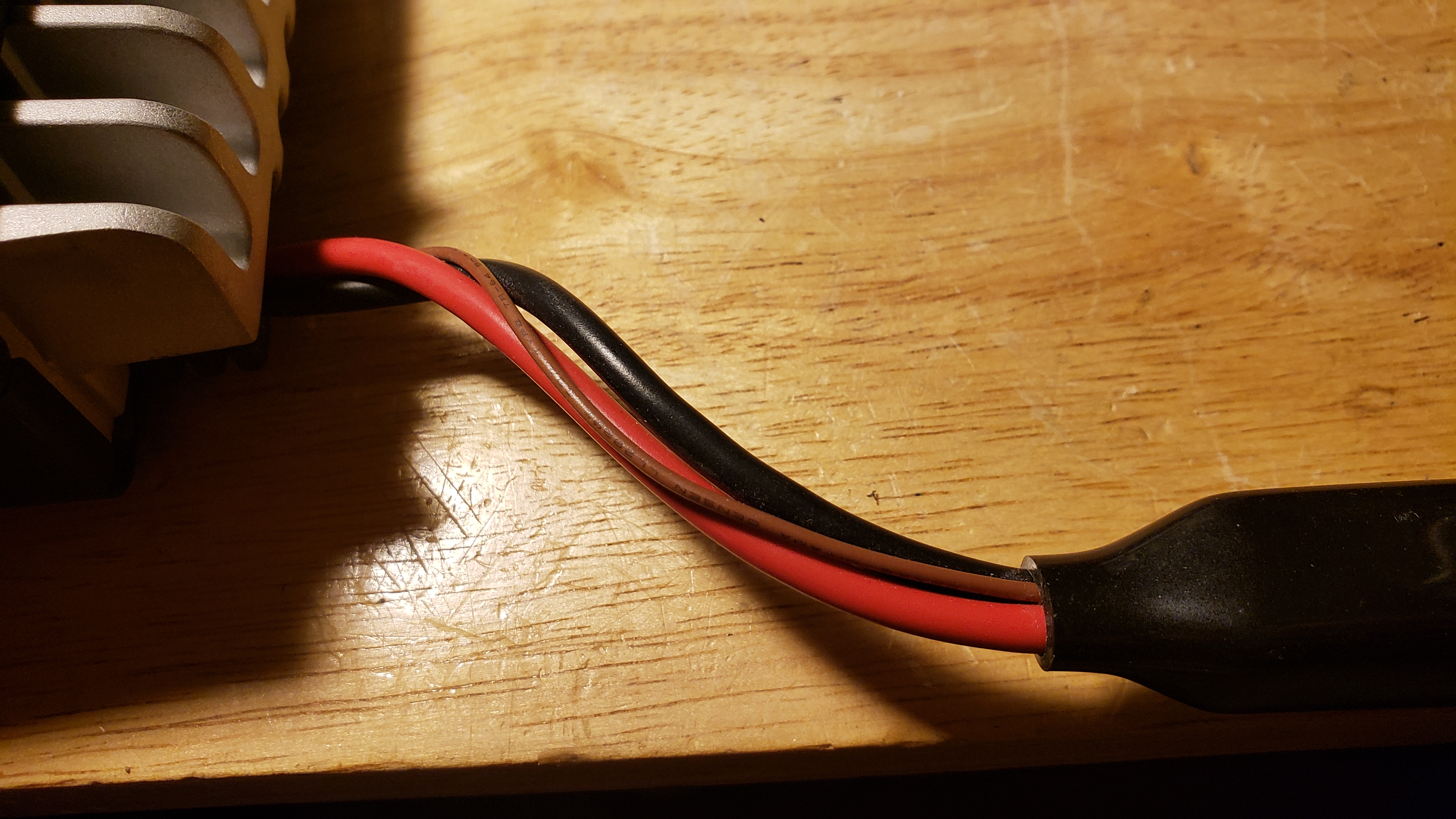

It is to be used with a power cord setup for battery power operation. You connect a ground wire to that pin and when connected to power it tells the radio to go into power conservation mode.Is it a sensing wire? I want to snip that plug off and put powerpoles on.
The power cord with the fuses doesn't contain the brown wire, only the cord on the radio side.That must be a carry over from the 897 when running on internal batterys.
My factory cord did not include the brown wire.
I have seen that info on the net.
When running on internal battery power the 897 is in low power mode.
Jeff
This is what you should have for your power cord.I looked at my cables and did not see any wires other than the normal red and black connections.
As long as you never plan running the radio in energy conservation mode it should be fine.Is the brown wire on newer or older rigs. I want to replace the Molex plug with powerpole. I don't like how honkery that pigtail looks. So, I can just clip the brown wire out the way?
