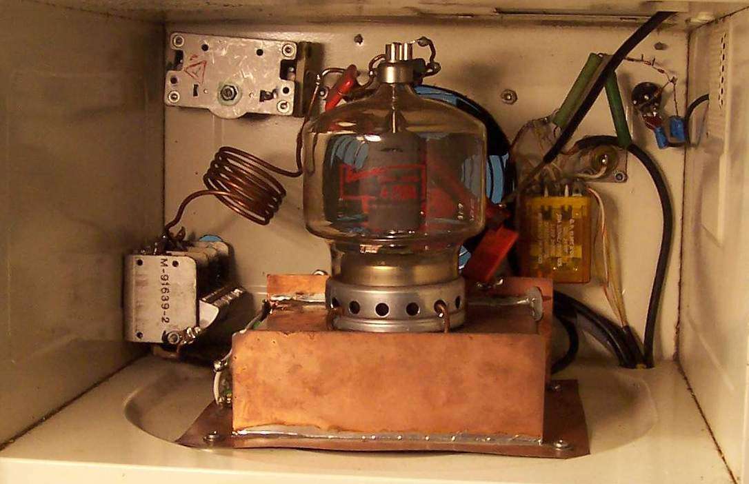

No, I didn't have anything to do with this one. A customer with an EXCEPTIONAL sense of humor just gave me the thing. Not too worried about ever trying to plug it in. No socket on the tube, gotta figure the tube's pins are directly soldered in. Some day I'll pull out the. ahem, "metal"-colored chassis and look inside.
Yes, it really was a Korean microwave oven, before this 4-250 tube got, er, "installed" in it. The pics of the power-supply wiring didn't come out right. I'll try again later. It's at least as humorous as the "RF" section shown here.
And yes, the Tune and Load controls stick out the rear of the thing. I'm told the Ebay seller said it was a working amplifier. I'm just not brave enough to light the fuse on a bottle rocket indoors.
But it's an example of what a person can do with mostly "found" and junk parts. Why is another matter altogether.

What is a Microwave oven, it is a 900 watt RF ampflier.
Yes this is a novelty project but, what you guys are snickering about is that guys construction technique but, the concept is solid.
Strip the internal chassis bare being careful not to disturb the outward appearance and mount a steel tube (GU-84b or GS-35b) horizontally thru the right side of the chassis. Inside the right side mount your transformer, diodes and, caps etc.
In the oven part you mount the tank circuit with the controls poking out the rear of the chassis; I would route my coax and position my relay behind the firewall on the right side.
Figure out a way to vent the hot pressurized air blowing thru the tube external anode and you have a 2000 watt amp packaged in a recycled Microwave oven case; a real hoot and a reason to have a Miller High Life every time your radio buds come around.

As I was driving down the street, it came to me that I was mistaken in what I said, it's an Oscillator that does 900 watts, not an amplifier.
