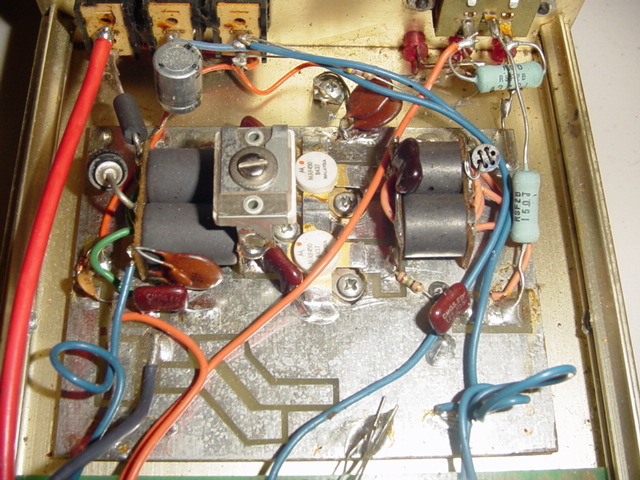

Who makes this amp and what class is it , I am assuming its a C class by the way its setup. It uses 2 MRF450's. Any other info on this would be great. Modifications ect...

Definitely appears to be class C because the bases of the transistors are grounded through that little VK200 choke attached to the input transformer. Not sure on a manu myself though..

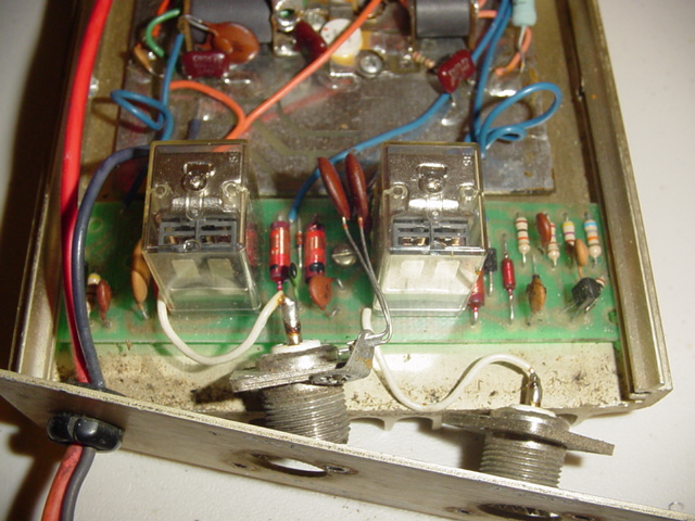

Ok anyone have any idea how I would replace the keying circuit with only one relay? I am thinking of putting the guts in a new cabnet. I don't need the pre-amp.
T23
T23
The second relay is most likely for a preamp stage in that amp, got a pic of the face? ie switches.
Yes Mack I know that the second relay is for the preamp. I have a keying circuit in mind. But was just wondering how to wire it to the board. I was going to use the keying circuit diagram of a Texas star skeleton 100 but apparently someone already made mention of it...

Yes but in my attempt to identify the amp thought it would help to see the front and did not consider that you would not understand it had a preamp circuit but it appears you have everything on that board to complete your circuit and it appears to even have a ssb delay circuit there also.
I have an old amp like that, has a G100 written on the front, not sure of the brand, but the guts look the same. I would love to make it class AB. Anyone know of a mrf450 am that is AB biased?
