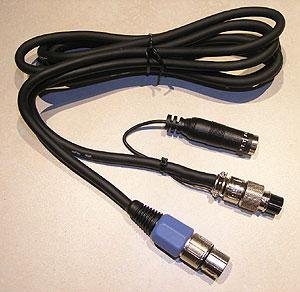

You could also just purchase any HEIL 8 pin to 3 pin XLR cable which will have the PTT pigtail connector installed. You would just have to check pin outs on the 8 pin radio end and move them around to match your radio.
