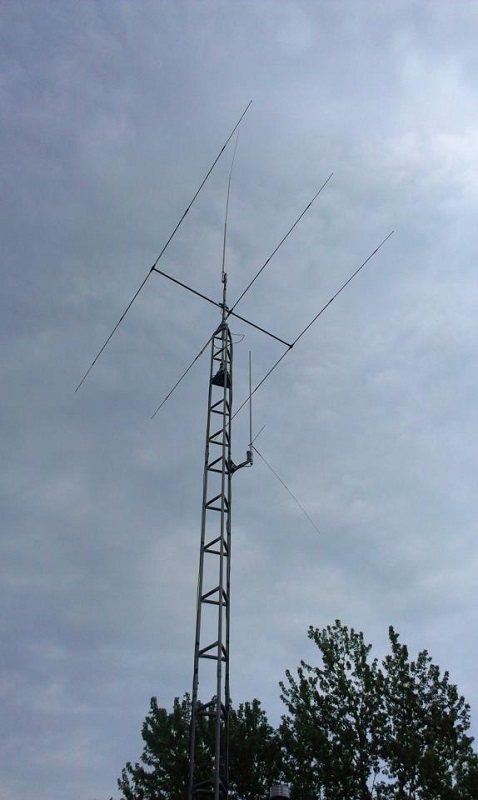

More interested in Amateur HF and 2 meter VHF for local talking than CB these days. As you can see from my picture I have a Sirio SY27-3 and a Imax 2000.
It would be nice to keep the Sirio yagi up for CB dx but not sure if my tower/mast is robust enough to handle 2 yagis and a Vhf yagi at the top.
My Ham 3 rotor is tower mounted so that should be able to handle a bit more wind load.
The Imax 2000 would be taken down and sold or stored away for a backup antenna.

I've no experience with that Cushcraft beam but for some reason I think I'd rather have the Mosley.
As for your tower, I think it you put those antennas on it you would do very well to guy it (didn't see any).
