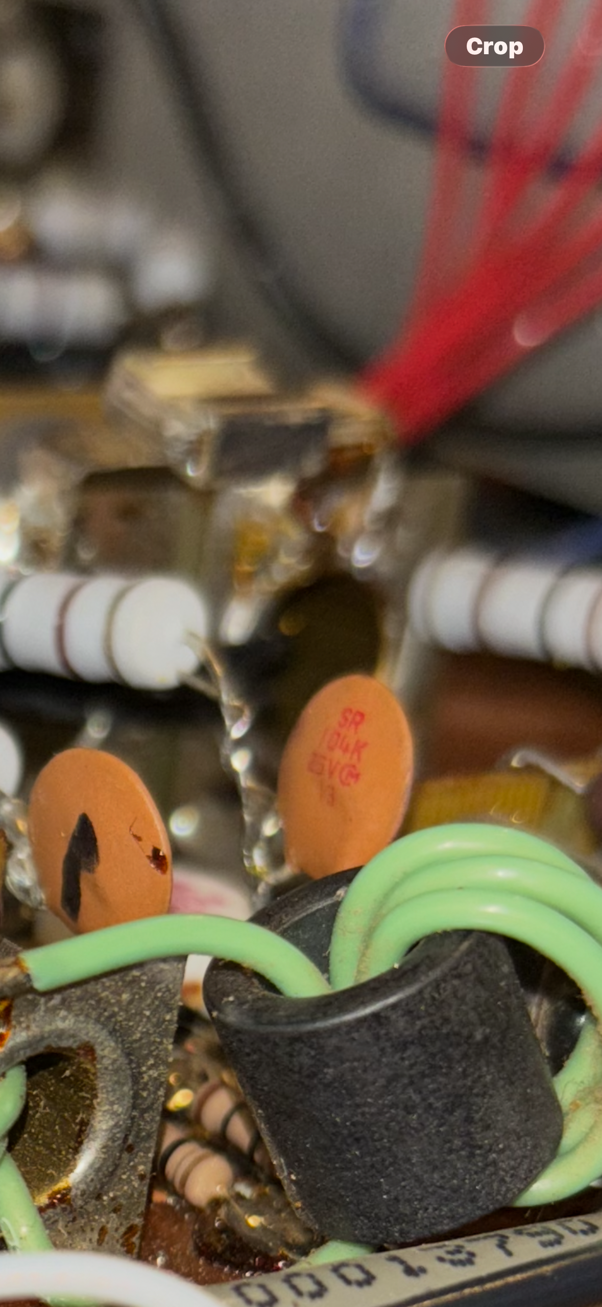

I have a x-force straight 10 pill converted to HG 2879 it seems to have a 2 pill section that falls off after it warms up. Not excessive heat. It looks like it has cheep 104 feed back caps. If one of them falls out of tolerance when warmed up will that cause that section to fall off? If so what is a good cap to replace them with? ICA has he’s some rated at 1kv. Would that be a good choice? Or something different? One of the 5 port combiner resistors is warming.
