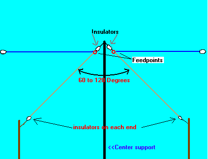

The antron 99 does "fair" for recieve on other bands. You really notice a huge difference once your below 17 meter, you can hear the signals but they are extremely attenuated. How hig up is your 99? you could always run a piece of coax to the base of where the antenna mounts and connect the center of the coax to one wire and the shield to another wire and run each as long as possible back toward the ground in whats call an "inverted "V" .
sorta like this dorky smiley >>>>> <img src=http://home.comcast.net/~shockwav/food_477.gif ALT=":crncndy">
since it will be for RX only you wont have to worry about SWR

the inverted V should be as far apart as you can,,,,,, example I have one wire attached by a string on a tree in the backyard and the other wire attached to the a string going to front of my house and your apex of 35 foot is perfect. dont let the wire hit and electrical wires or any metal the longer the better.

As the picture above with the copper colored lines show the shield is connected to a copper wire on the left and the center is connected to the other copper wire on the right just ignore the insulators on the top because you wont need them for listening,,,,,, all your doing is using your coax so its easy to connect to your radio solder the shield to the wire to the left and tape it up so water does not go into the coax then solder your center to the other wire and black tape it up then just hang up the center up as high as you can just dont let the shield or center or any of the wires touch metal. All your doing with the 2 wires you just soldered is making sorta like a indian teepee
That Help?
