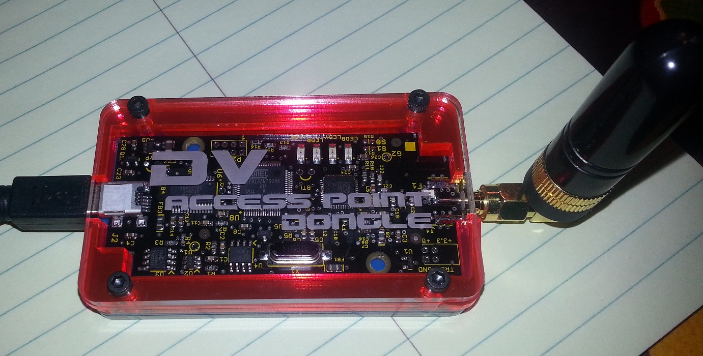

It works AWESOME ! I stay connected most of the time and I just picked up a DVAP so I will have access at work as well !
I had to get the fancy lexan case for it as well..
