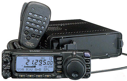

The FT-857D is a nice little rig.
It doesn't quite measure up in performance to it's older brother the FT-100D,
but is still a great rig, and probably more reliable, IF you don't get a problematic rig as have several
local operators.
If you want a microscopic all-mode / all-band mobile for a very attractive price, the FT-857D is it.
But, If you want a little better 10/11-160m rig and can live with both a used rig and a little larger
detachable face, then you could be very happy with an FT-900AT
http://www.aade.com/hampedia/yeasu/yeasu1.htm#ft900
- Especially if you like AM, as the FT-900 (an FT-890 in mobile dress) can sound quite good for
a 'rice-burner', and has provisions for both an AM filter, and a Collins SSB filter, which is a
worthwhile upgrade for either rig.
The Collins filter makes a real difference in both RX & TX selectivity while sounding actually wider and fuller tone due to the steeper slope shape factor.
I've owned 4 FT-100Ds, had prolonged use of both the FT-857D & the FT-897 and now own an FT-900sat and a couple of remote kits and love both the larger readout / face & the internal tuner which I use to match the input to the solid state 667 '10m' amplifier for lower bands (with a few combiner mods it now provides ~480w PEP on 3.8mHz).
The one drawback to the FT-900 is it's availability, few come up for sale due to it being much loved by it's owners, but the remote klts are still available.
