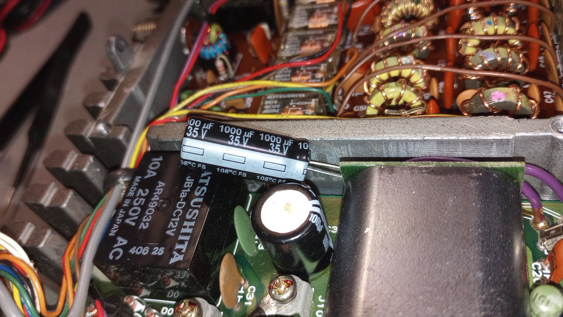

I was just eyeing that old dead battery wondering what to replace it with, so a 2032 huh? I can manage that, thanks Greg, and the point about the the thermistor is also noted as it takes a while for the fan to turn on, heats up more than I'm comfortable with. It does spin up at boot. I haven't recapped the 100w power board yet as the 1000uF cap in the kit is too tall.
I need to find a shorter version with some girth to it.
