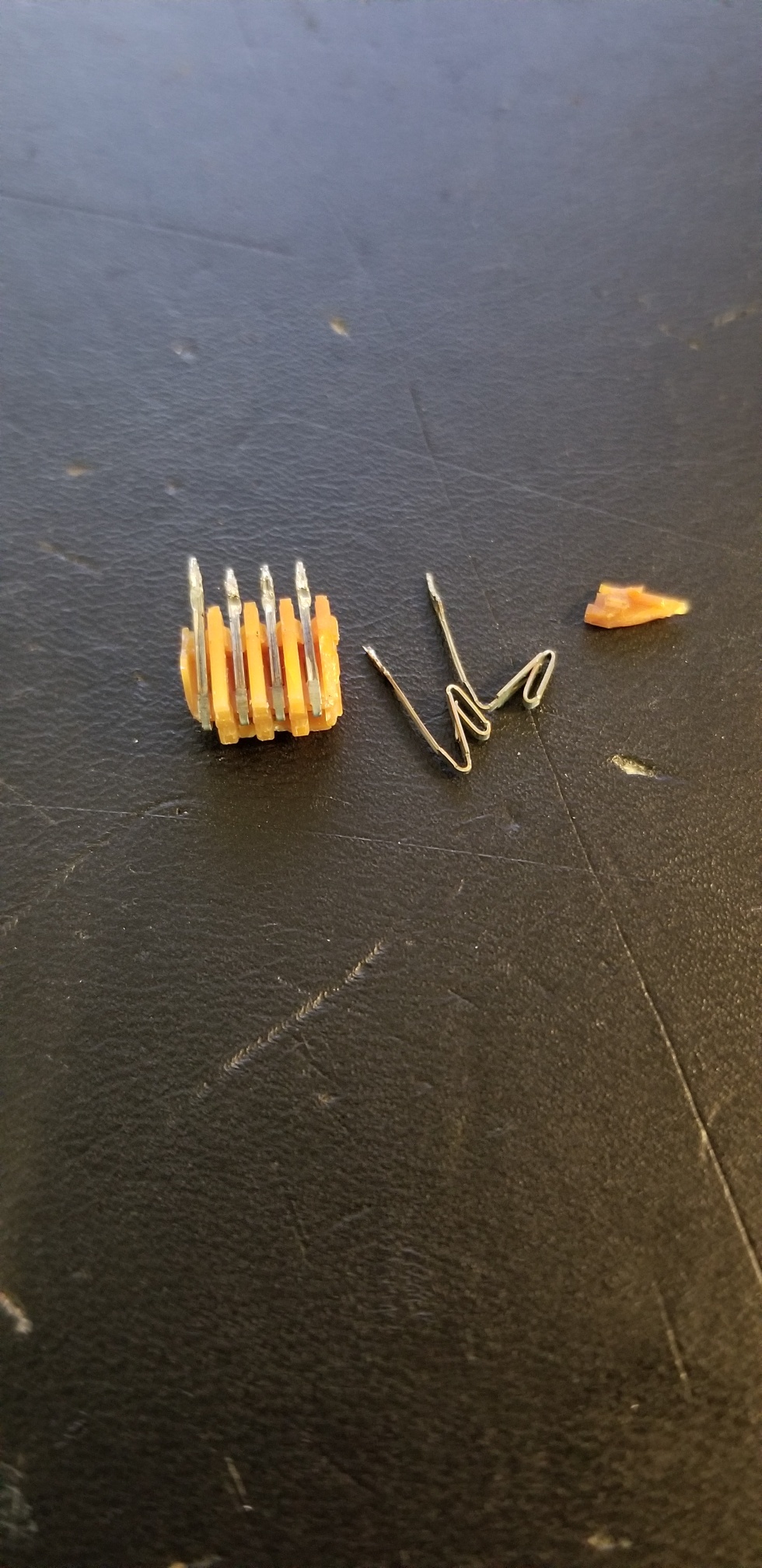

    Here is a pic of the connector removed from the radio. It is supposed to be a 6 pin connector but as you can see it has broken apart. I did speak with someone in the Yaesu parts dept and they said that the part number has been discontinued and they are looking to see if there is a replacement part. Also, you can look up the video on mikes radio repair y-tube site and see him take this apart.

    Here is the latest on the Yaesu. I spoke to someone in the Yaesu parts dept in California (again) and she did some research and was able to find the updated part number. As it turns out, they have a "ton" of them in stock. If all goes well, I will have 3 coming my way tomorrow.
    Oh, you probably want to know what that new part number is? It's P0090624.
    It's the small victories that count, right?
