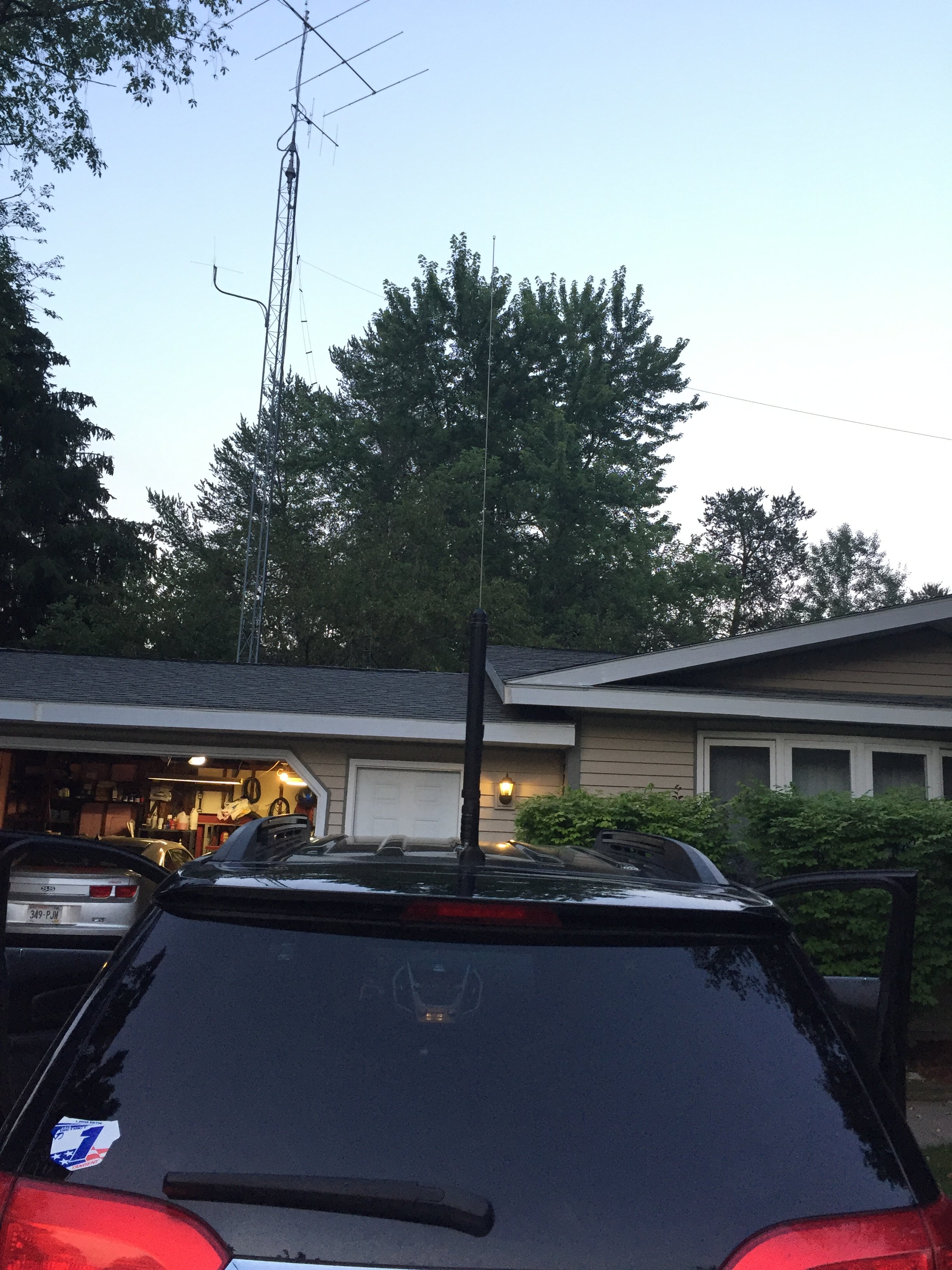

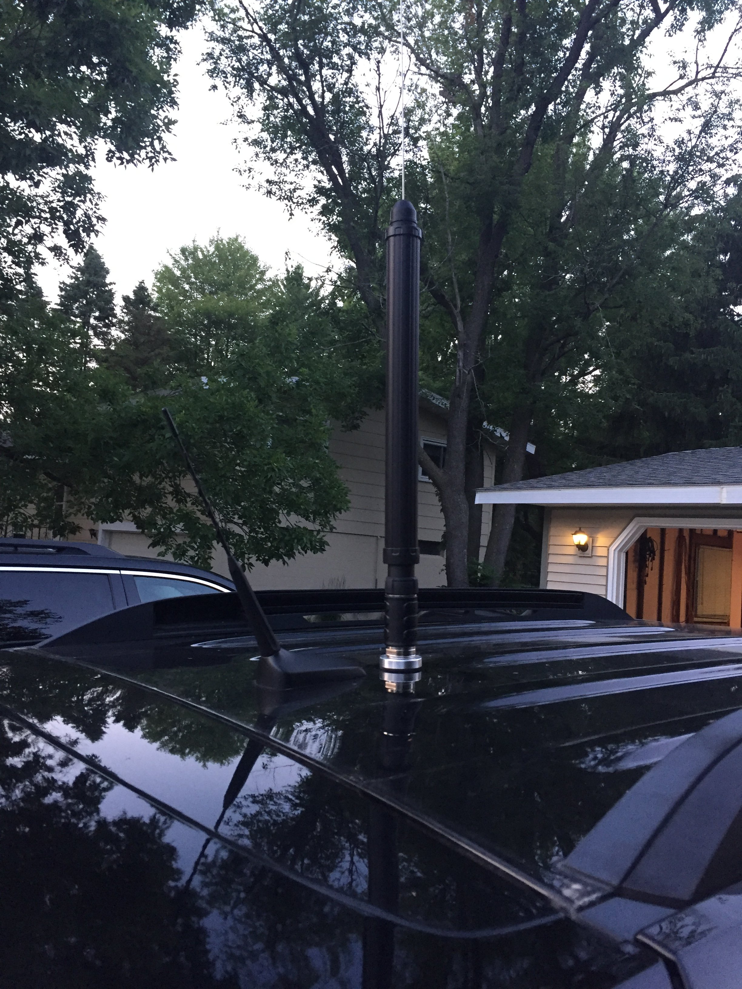

Would be great if you can post up pics of your install. I think there is a lot of interest in this rig and antenna combo, but most of the stuff out there is for the FT-857D.

I'm leaning towards a 2" Breedlove Puck Mount. Going to put it on the front winch bumper. I may go with a ball mount on the right rear quater panel, too. So far, the bumper is ahead in my thinking.
I realize there are better mounting locations and more efficient antennas. My mobile setup will mainly be used for regional contacts. I'm not a DX hound. I still need to explore QD options, since my jeep is used heavily on our farm. I mostly use it as a log skidder. I'd hate to twang it off on something.
