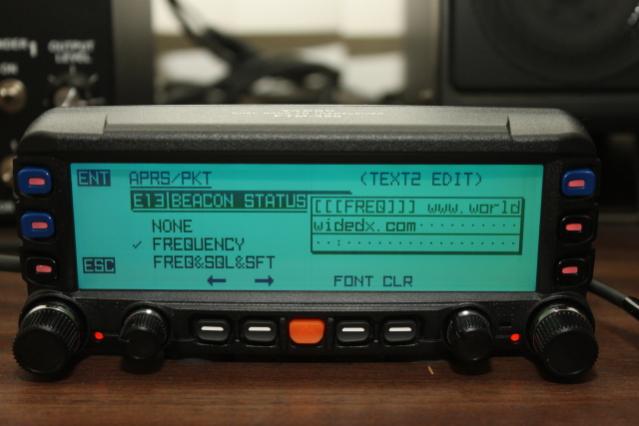

will aprs show what freq. i am on or do i just send a msg that show when someone looks @ my call and then they can see that i sent a msg as to what freq./rep. i am on.. dont know probly a stupid question..
Not a stupid question at all. APRS supports encoding a frequency in the packet that tells everyone what frequency you're monitoring for a voice QSO. Most people call that the "QSY" frequency. To include that info in the beacon, the radio must support that functionality, otherwise you have to include the info manually in the beacon text. The cool thing is that if both the sending radio and receiving radio support the QSY functionality, changing to the voice frequency is usually done by just a push of a button. The FTM-350 does support this functionality.
To enable it, go into the APRS/PKT setup menu and choose menu E14-BEACON STATUS TXT. Under the new menu popup, choose item 1 - SELECT: and set it to TEXT1. Now scroll down to item 3 TEXT1:, push in on the dial select and then scroll down on the new screen and choose FREQUENCY. You can also add additional text after the frequency if you want. The screen you should be changing is this one:
