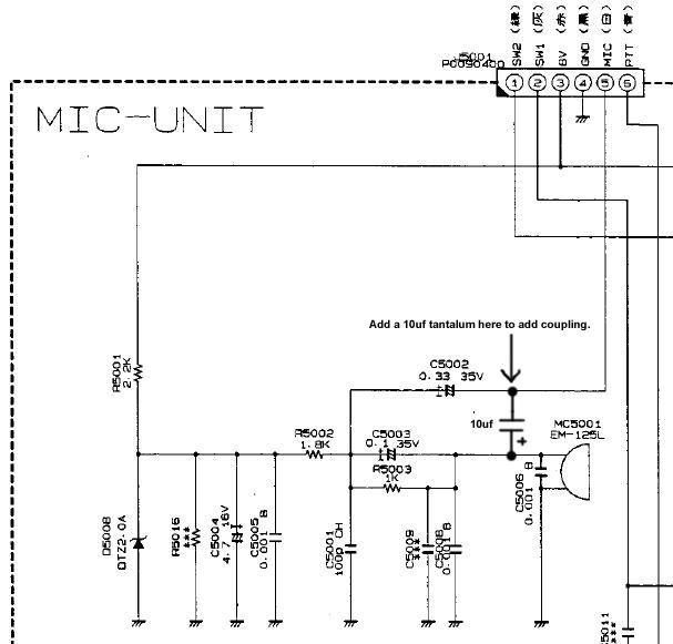

Are you sure the element is open? How did you check it? Is the element getting the requires voltage to it? Is the series decoupling capacitor C5003 open? It is an electret element and requires power to operate and generally shows a very high impedance when checked with an ohmmeter. See the schematic below.

Ill have a look at that schematic than trouble shoot the circuit. thanks CK for the schema!
