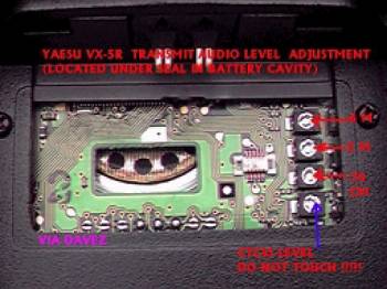

1. Remove battery.
2. Remove the cover for Pressure Sensing Unit [SU-1]. Refer to owner??????s manual.
3. Remove the SU-1 if installed.
4. Locate the solder pads on back of the transceiver.
Solder pad configuration for USA Mars/Cap mod.
X = not soldered
O = soldered
XXXOOOXX-Factory
XXXXOOXX-Mars/cap
XXXXXXXX-Freeband
VERSION 3
9Fxxxxx
Solder pad configuration for USA Mars/Cap & Freeband mod.
X = not soldered
O = soldered
XXXOOXXX-Factory
XXXXOXXX-Mars/Cap
XXOXOXXX-Freeband
