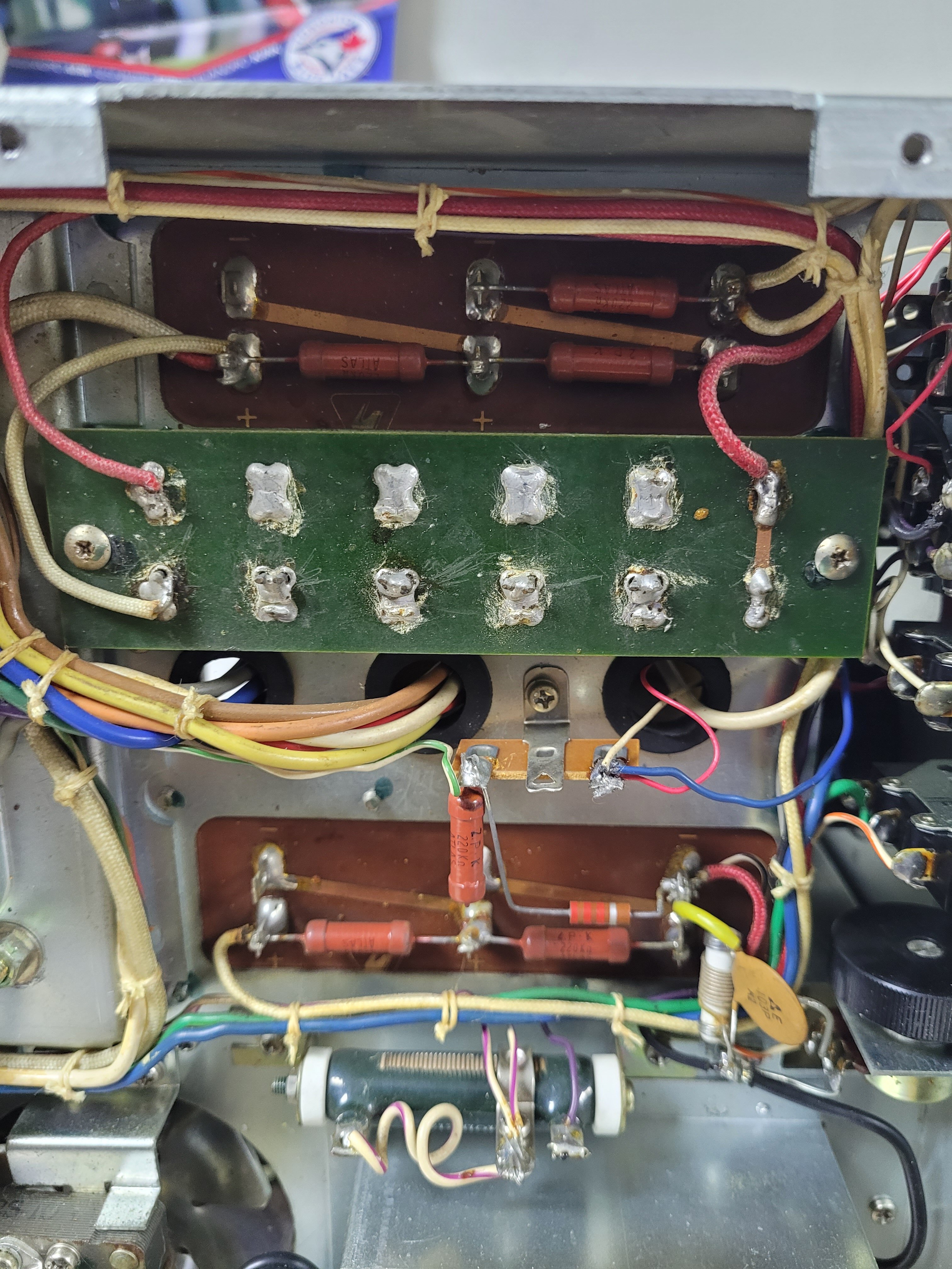

thank you kindly for the information yes it shows plate voltage and no the relay dont click sorry i said alc it is the ry screw i can see the radio out put if i put radio on fm then output shows up on meter (bird) i have owned it for 20 years and it has worked great. i never abused it never ran at full power for long. but after reading your information it was the first time i have open the amp up too look i believe if it works keep your hands out. but when i was looking to see where ry goes i noticed that the board under the main caps there is some dioades or resisters have been removed this had to be done before i bought it. i was very suprised to see how clean it is inside. i really thank ful for your help here in alberta its hard to find some one honest enought to trust at price of labour. this picture of the removed parts

If the relay won't go click, the first suspect is the 1000uf 25 Volt filter capacitor. If it's the original part, it should have failed years ago. When it does, the voltage needed to close the relay won't be sufficient.
