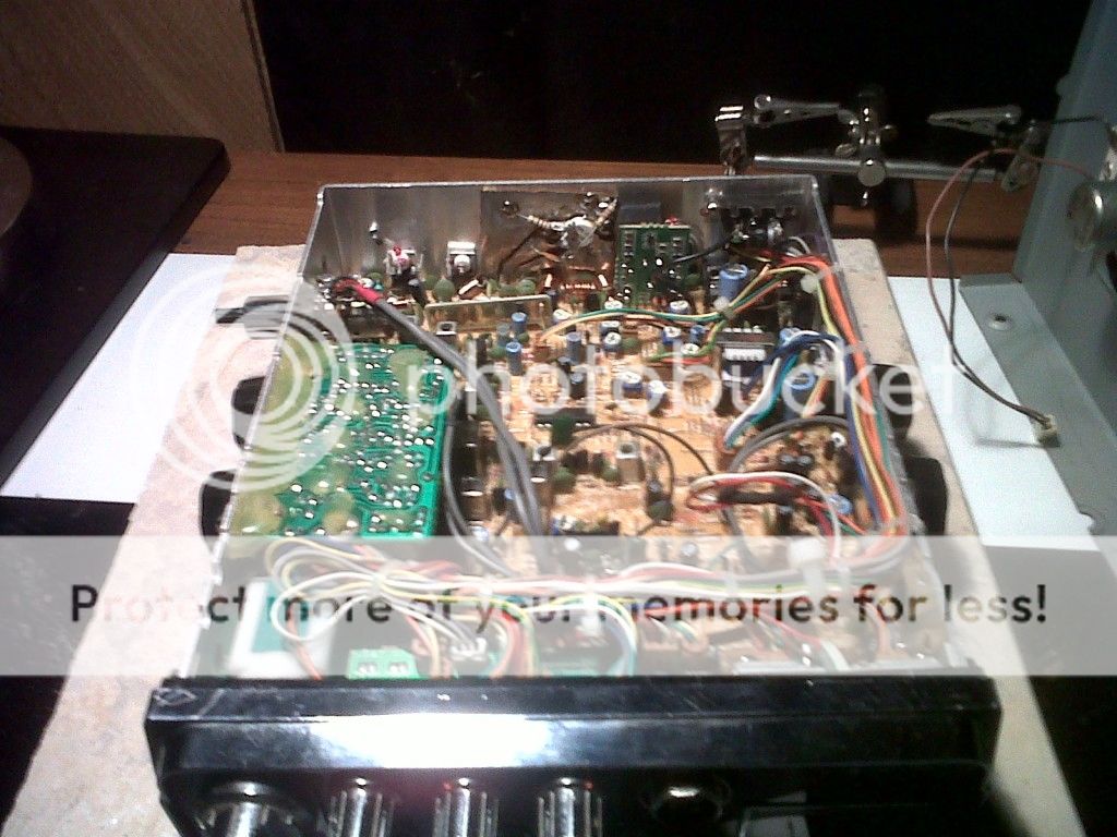

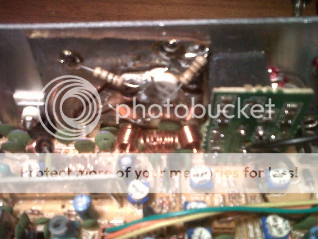

I had this come across the bench a few months back. A 979 with a 1446 final "truckstop rigged" in there. It worked but the biasing was non-existant of course.
This is not my work lol, but I did get it "to work".
AM was about 80 watts PEP.
