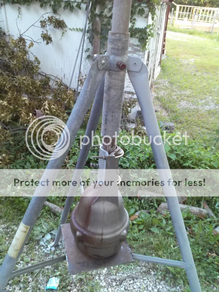

Yesterday I finished modifying a pair of Rohn TRT60 5 ft tripods to be a little stronger and to accept a Ham IV rotor
I need to decide how to mount the antennas...

That thing will never support the weight of those antennas. You need a hole for the 8 wire cable. Those arms will not hold the weight. The wind load will twist it li a pretzel. Start looking use Rohn 25.

Watch out for that rotator binding. Those rotators will not rotate concentrically unless the mast size is 2" O.D. unless it is shimmed. I ran one for 30 years. It only has one moveable plate. The Yaesu rotators have two moveable plates that allow for concentric rotation regardless of mast diameter. I use one of those as well now.

I took that into acct while modding these I made sure everything could rotate smoothly before I started to weld everything in place
So you actually had the rotator operating to turn things before you welded things in place and you took the off-center rotation into account? Still not sure how that would work out because the entire mast will not rotate in a perfect circle unless the mast is the proper size. It will still rotate off center. The only way to account for it would be to shim the base of the mast to make it the proper size or leave LOTS of slack in any bearing or sleeve above it. Lots of slack.
