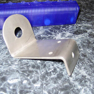

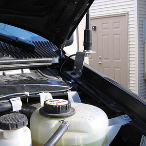

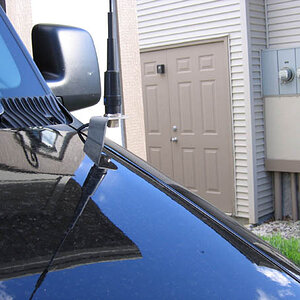

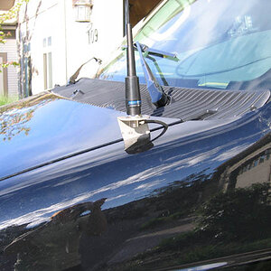

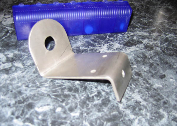

Mount I made up using a waterjet. 12 gauge stainless steel. 2 3/4" tall, 2" wide, 15 degree angle for hood slope. 5/8" hole for antenna. Mount bolt
