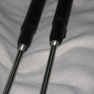

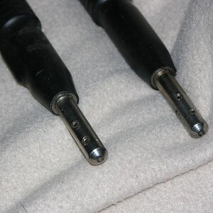

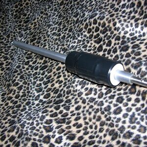

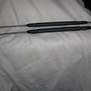

stainless tip, copper coil, aluminum shaft, stainless allthread in bottom. shrink tubing over copper wrapped around solid delrin insulator.
yes. Actually it could be made to resonate at almost any frequency- the coil is tunable, plus any length whip could be used, but it was made to be a cheap, durable cb antenna.
