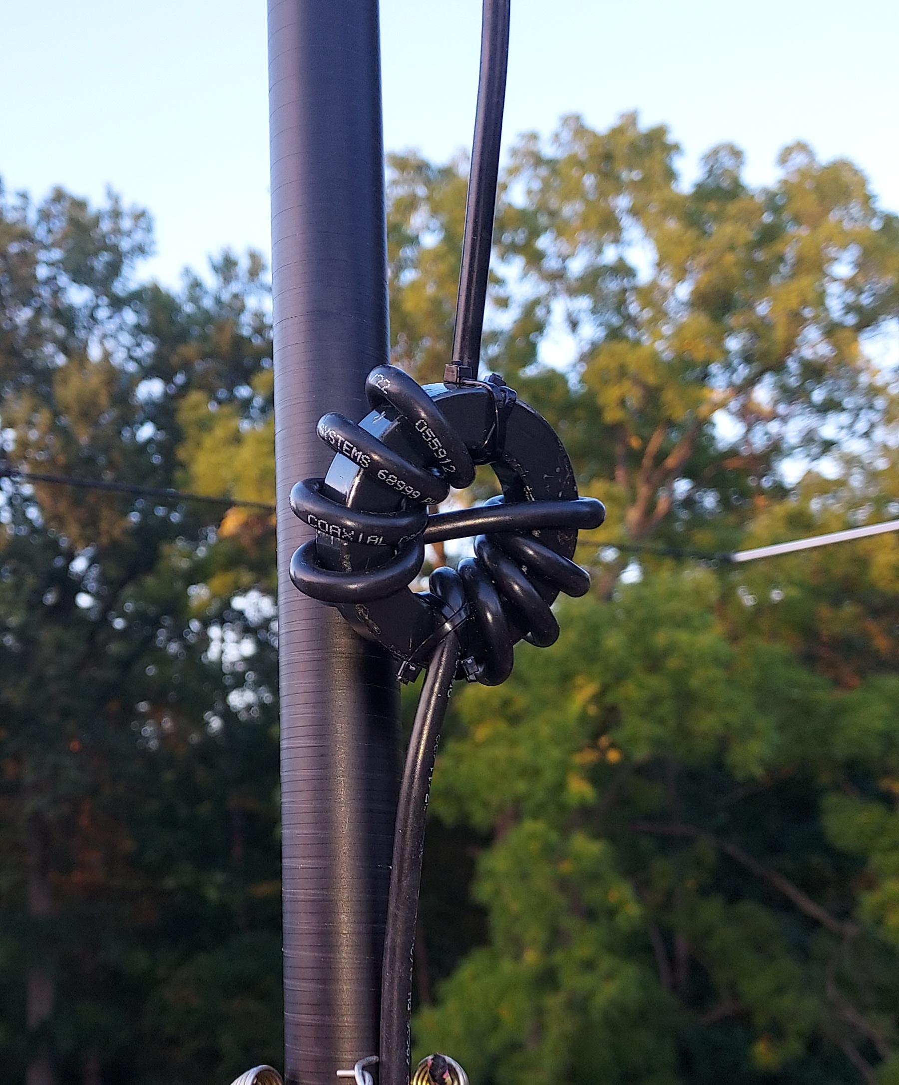

A 1:1 balun/Common Mode Current choke is also fairly easy to homebrew, cheaper and higher quality than many on the market.
They can be made using coax:
View attachment 70016LMR240-Ultra Flex. A little pricey but worth it.

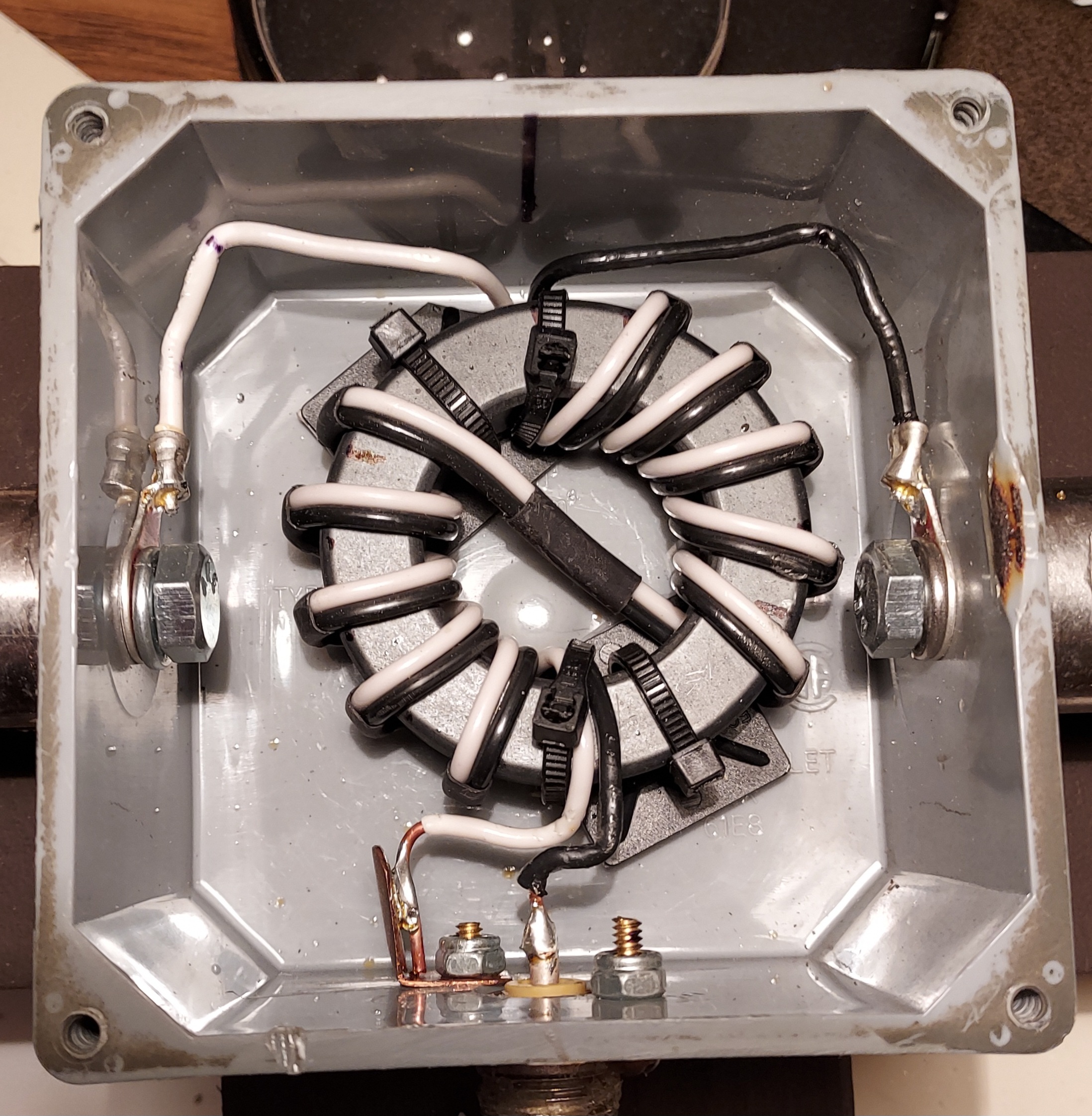

or Bifilar wound with solid copper wire pulled from Romex house wire:
View attachment 70017Stick it in a watertight box, makes a good, easy feedpoint for a dipole. Both are Fair-Rite FT240-43 mix ferrite toroids. $10-$12ea. on Crapazon.
