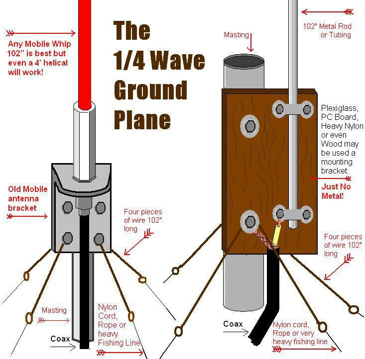

10m?
Shorten these numbers about 5%...you have a 10m Ground plane antenna

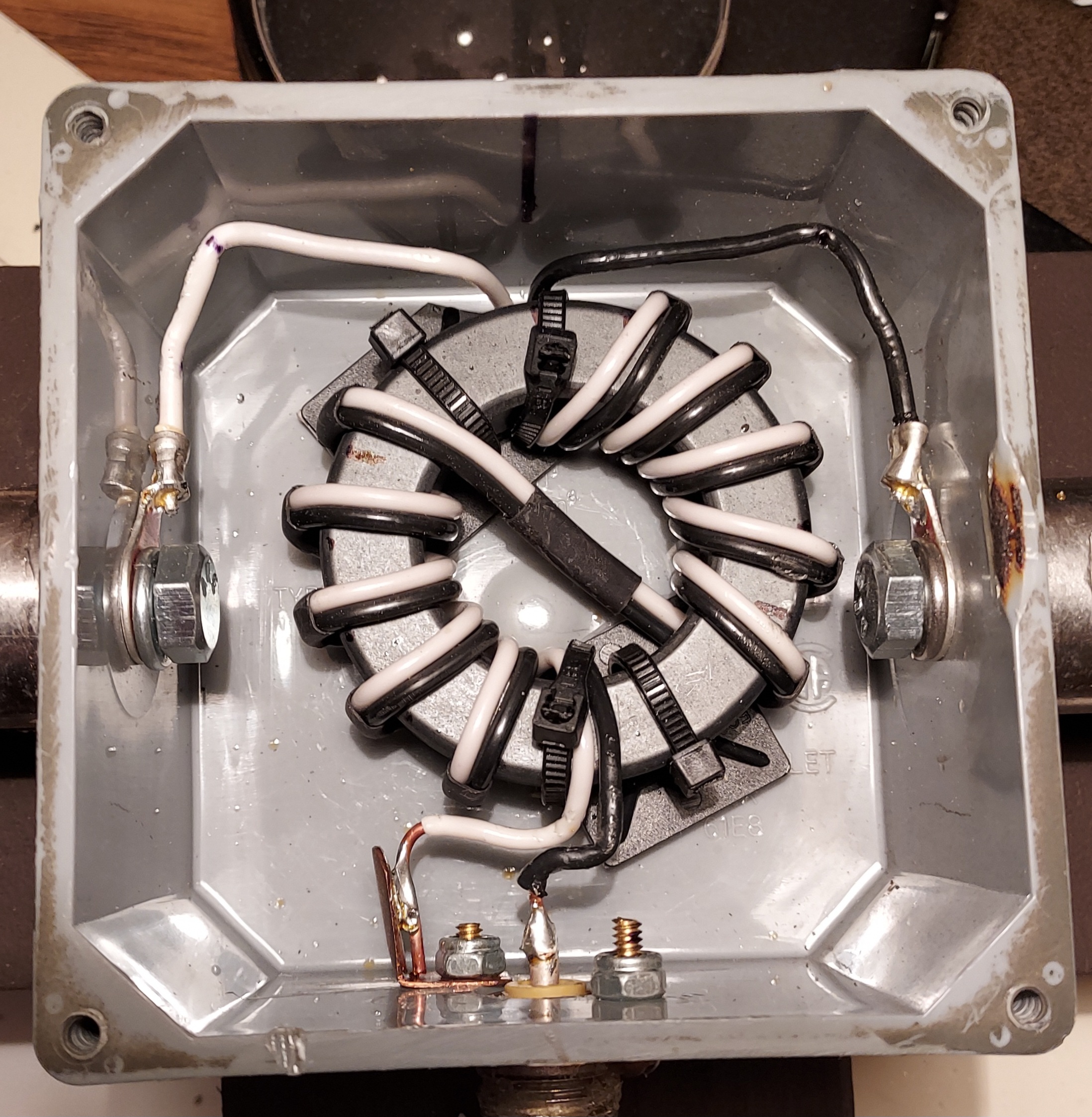

A 1:1 balun/Common Mode Current choke is also fairly easy to homebrew, cheaper and higher quality than many on the market.

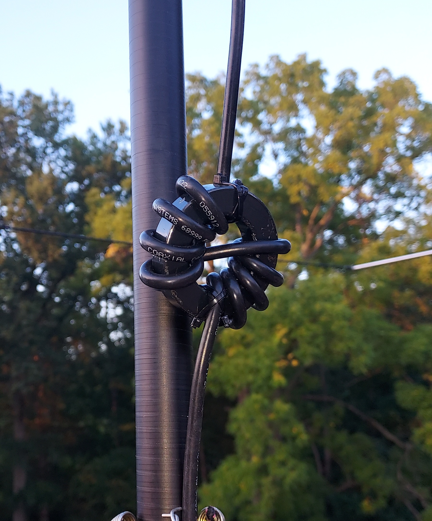

They can be made using coax:
20240831_193446.jpgLMR240-Ultra Flex. A little pricey but worth it.
or Bifilar wound with solid copper wire pulled from Romex house wire:
20220903_182034.jpgStick it in a watertight box, makes a good, easy feedpoint for a dipole. Both are Fair-Rite FT240-43 mix ferrite toroids. $10-$12ea. on Crapazon.
