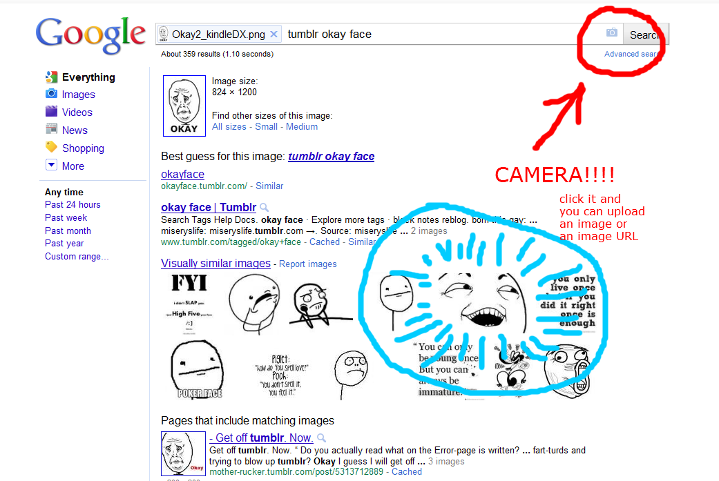

Google is my friend. :thumbup1:
I just didn't (and still don't) know what your post was about. were you trying to say that Google will now search websites for a specific image I want to find? A bit useless if I already have the image. :laugh:
