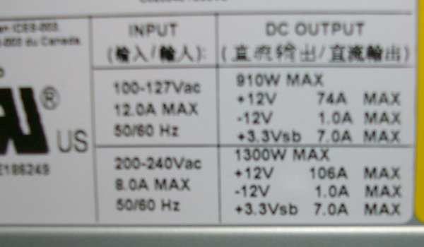

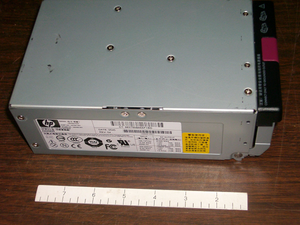

Mainframe computers have utilized high amp switching supplies for several years, and many of these supplies are now showing up on the surplus market. Last week, I purchased an HP mainframe supply from a surplus outlet in Medellin. This particular supply is rated at 12V-74Amps (110vac input) or 12V-106Amps (220vac input). The supply was "reconditioned": i.e. - cleaned, and run at maximum output (94 amp draw) for 12 hours. It measures 6"W x 4"H x 8"D, and weighs about 4 lbs. The cost was 49000 pesos (approx $22USD). Like PC supplies, this unit is "hot-pluggable", meaning it won't turn on unless it's connected to the mainframe. When I mentioned that I was going to use it to power some of my radio equipment, the store's tech showed me how to hot-wire it by connecting 3 pins on the plug together. He also showed me how to adjust the output voltage, and set it to 13.4vdc, which is the max the supply will do.
I tried it out today, and it easily powered my 5-pill TX600 to 800W peak with negligible (.15V) voltage drop.
The plan now is to build a housing with a voltmeter, ammeter, external voltage adjust control, and some high amp connectors. I also need to change the cooling fan to something quieter. I'll post some pics of the finished unit in a few weeks. 73s.
