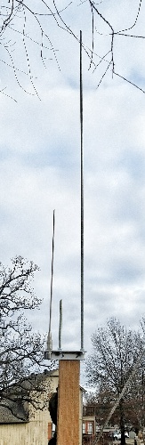

    I made one of those arrow 2m/70cm jpoles last week. Seems to work just fine. Pretty easy.
    A piece of angle 6" long, less than 6' of all thread rod, and a cut down whip antenna.
