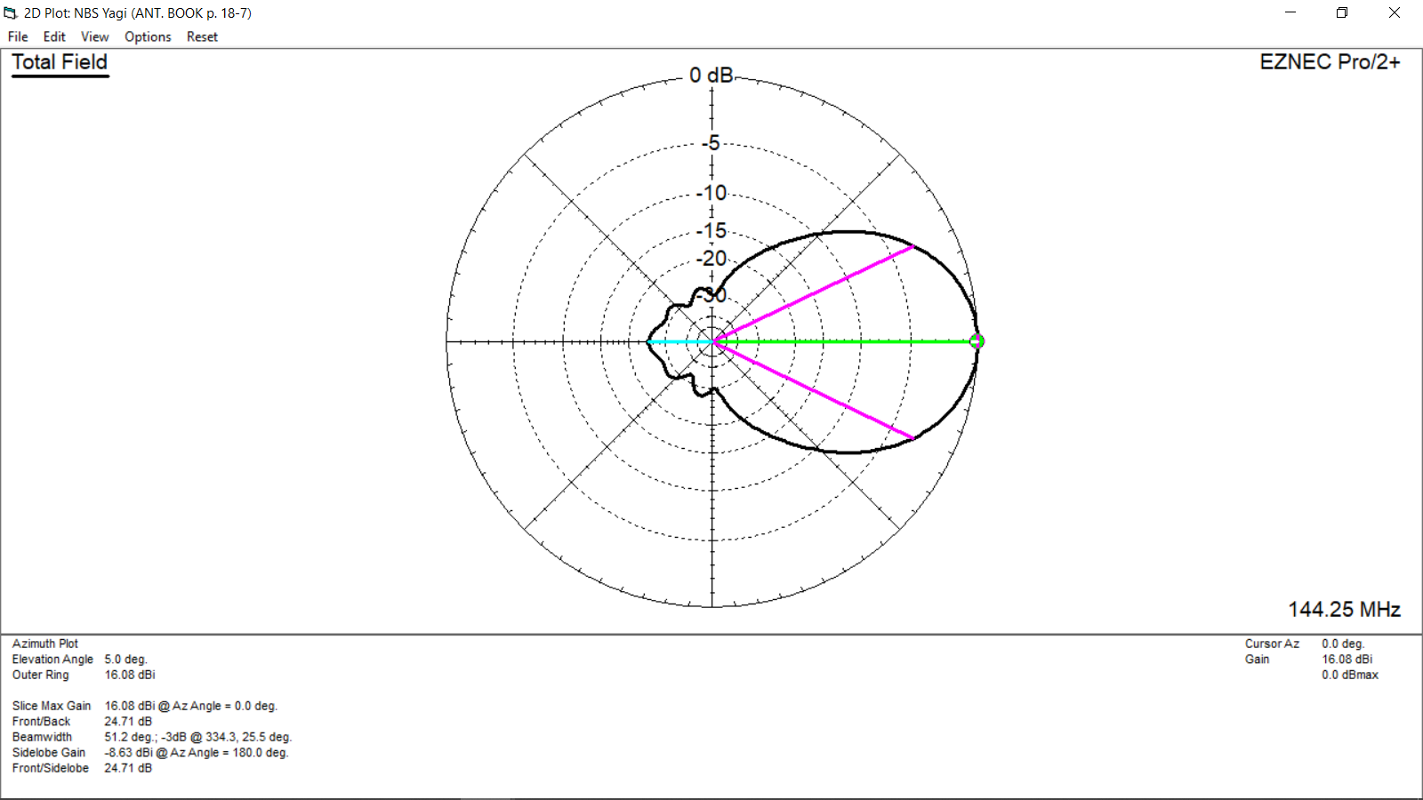

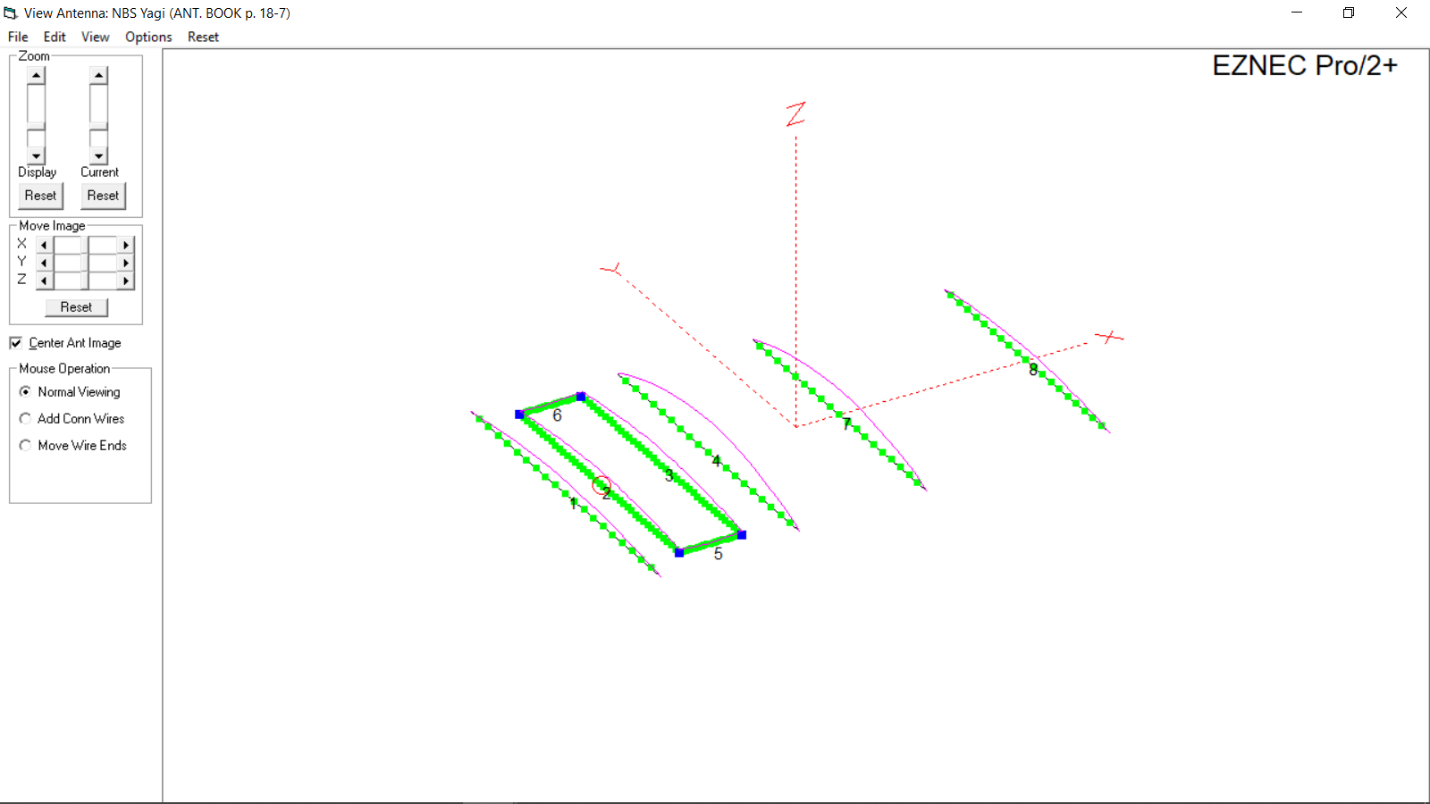

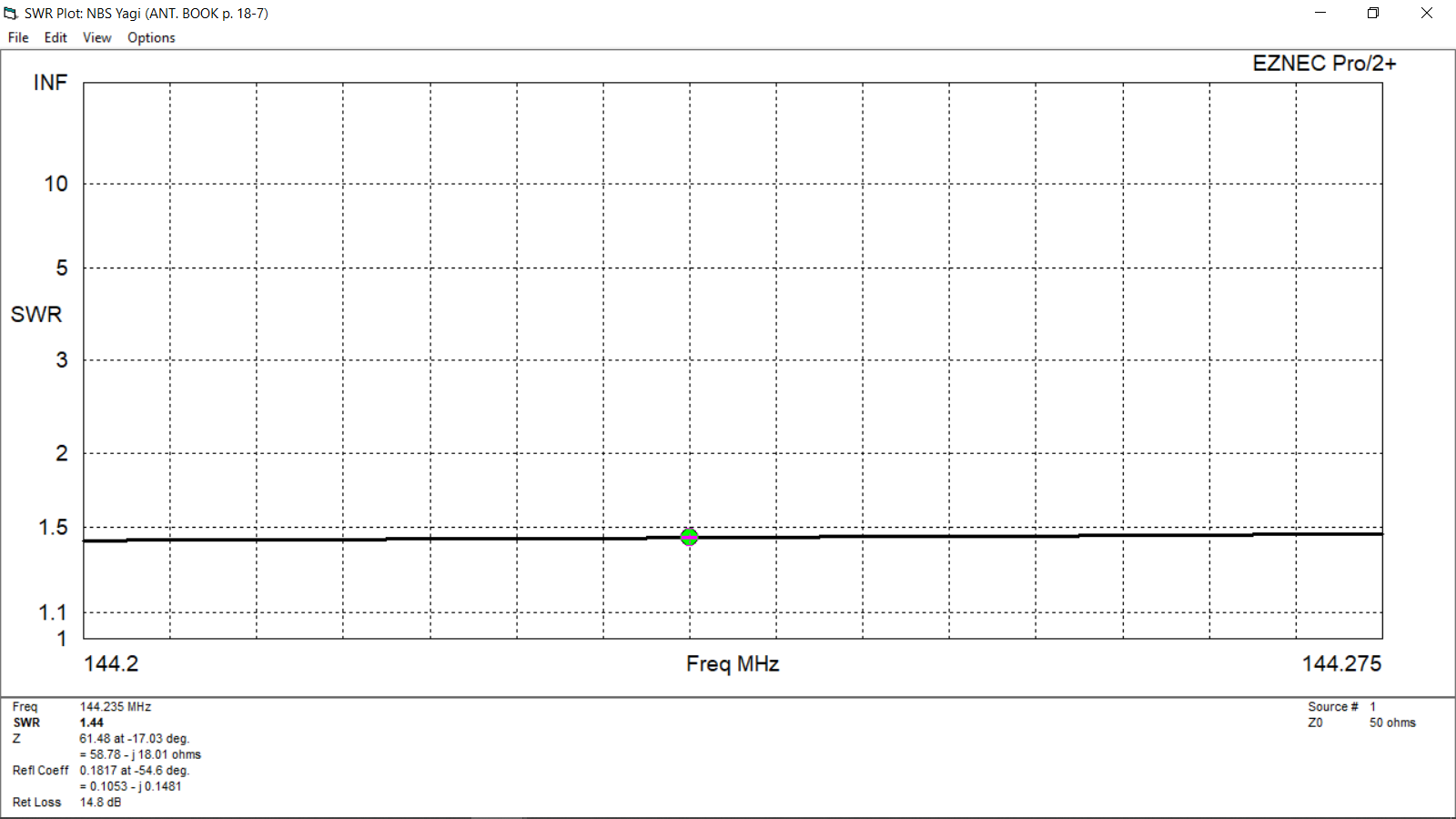

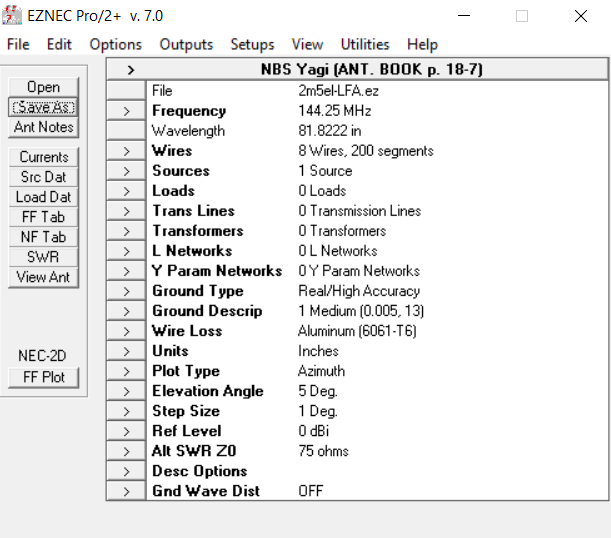

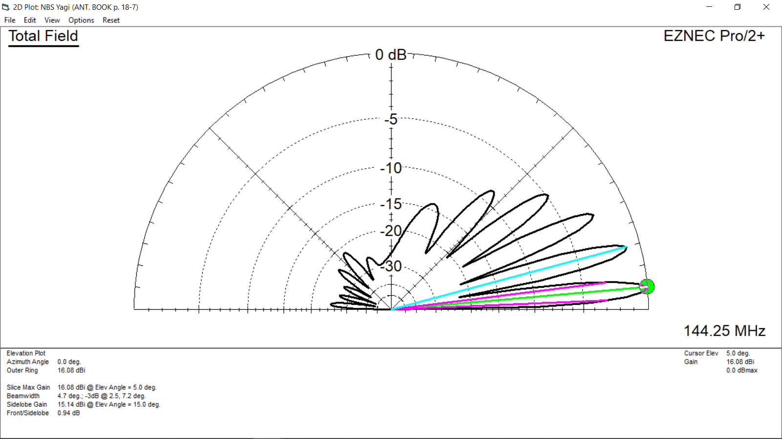

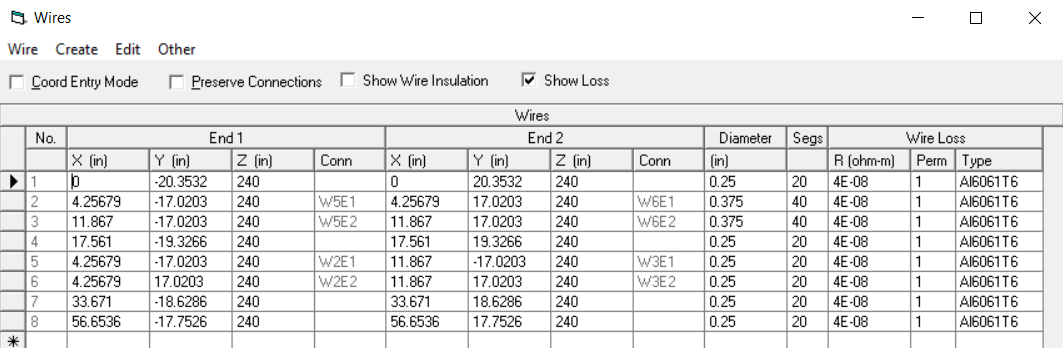

My bet is no one here will try to build one, but here's a quick model of a 5 element LFA Yagi @ 144.25 MHz.
Elements are made from 3/8" and 1/4" aluminum tubing, boom about 4'-9" long.
One of the the really good things about Loop Fed Yagis is their natural 50ohm feedpoint impedance. No lossy, finicky, tricky matching device needed, just a direct coax feed to the Driven Element loop. This one shows some pretty good gain and front/back with just 5 elements.
Screenshot (163).pngScreenshot (164).pngScreenshot (165).pngScreenshot (166).pngScreenshot (167).pngScreenshot (168).png
The SWR could easily be lowered to 1.1:1 or less with some tweaking of element lengths and spacing in the model.
These antennas are not very difficult to homebrew if you're in to that.
