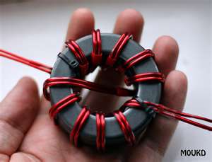

Then how do you make a 1:1 balun?
One way is to use a trifilar winding. (three wires)
Here's pictures of proper current baluns: one using parallel wire, and the other using coax. Both are designed for 50 ohms.
The three wire Turrin balun shown above is a voltage balun that has no choking capability.

Hi Doc,
Get the book "Building and Using Baluns and Ununs" by Jerry Sevick, W2FMI. Section 1.3 describes the choking capabilities of a Guanella "choke" balun.
In it, it states: "Several important points should be made regarding Guanella's 1:1 balun shown in Figure 1-2A. With sufficient choking reactance, the output is isolated from the input and only flux-cancelling transmission line currents are allowed to flow. With matched or very short transmission lines, the grounding of terminal 5 (actually or virtually like the center of a dipole) results in terminal 4 becoming +V1/2 and terminal 2 becoming -V1/2 -- creating a balanced output. This type of of balun has lately been called a 'current' or 'choke' balun."
Thus, the "ugly" choke balun is a form of the Guanella current balun. And if all Guanella baluns are choke baluns, then it is true that the 1:1 Guanella balun is equal and the same as a choke balun. Thus a 1:1 current balun ='s a choke balun. In fact, any form of a Guanella current balun is by default a choke balun, be it 1:1, 2:1, 1:2, 4:1, 1:4, 6:1, 9:1, etc.
