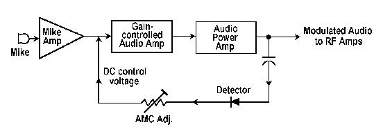

Automatic Modulation Control in Solid State Transmitters
Typical Automatic Modulation Control Circuit
a small sample of the signal is fed from the audio power amplifier back to the gain controlled audio amplifier in the early stages of the input chain to prevent overmodulation on voice peaks and adjacent channel interference while providing (increased intelligibility) low levels of audio compression.
in the event that the sample exceeds the baseline established by the variable resistor the dc control voltage reduces the input to the gain controlled audio amplifier. by the same process, if the sample is below the baseline the dc control voltage is such that the input to the gain controlled amplifier is increased and all of this is done automatically the entire time the transmitter is being modulated.
the circuit operates in much the same way as the receiver AGC. low input, amplification is increased, high input, amplification is decreased.
in the case of AMC, disabling it DECREASES the average amplitude of the modulated waveform (bad) relative to the PEAK levels. with the AMC active and properly adjusted the average amplitude of the modulated waveform (good) is noticably higher when referenced to those same PEAK levels.

Umm, okay. The block diagram above doesn't really match what's been found in most SSB CB radios made since the early 80s.
There's a capacitor between the modulated audio and the detector. Sure, that's what's in a Cobra 29.
But all the RCI and Uniden SSB CB radios for decades have a DC-coupled connection between the modulated power to the transmitter final/driver and the detector circuit.
A series pair of resistors taps a tiny sample of current from the modulated B+ that comes out of the modulator circuit. The point where they join now has a smaller copy of the modulation waveform being fed to the driver/final. The emitter of a NPN transistor connects there. The transistor's emitter voltage is now "riding" along in step with your voice waveform. A trimpot sets the transistor's base terminal to a steady DC voltage. The audio waveform now riding on the NPN's emitter will fall to that magic six-tenths of a Volt lower than its base voltage if you turn the mike gain high enough. As soon as the 'down' side of your voice waveform falls to this threshold, the NPN transistor turns on, and the voltage ripples downhill to the mike amplifier's attenuator transistor. The next negative peak to come around will be reduced until the modulation is held down to the level your trimpot setting will allow. You can turn it all the way up so the peaks go all the way down to zero. Zero Volts is 100 percent negative modulation. Or you can set it the other way and never allow the negative side of your voice waveform lower than 30 percent negative modulation.
Yeah, a diagram would probably help this picture.
Anyway, just remember that the modulation limiter in a lot of radios only controls the negative half of your voice waveform. It will hold that negative modulation percentage below the setting the trimpot dictates. But it has no idea about positive peaks. Doesn't need to.
So maybe I'm really just splitting technical hairs here. I was just a bit disappointed this part of the picture got skipped from an otherwise lucid explanation.
Just one of my bad habits. Griping about what gets left out.
