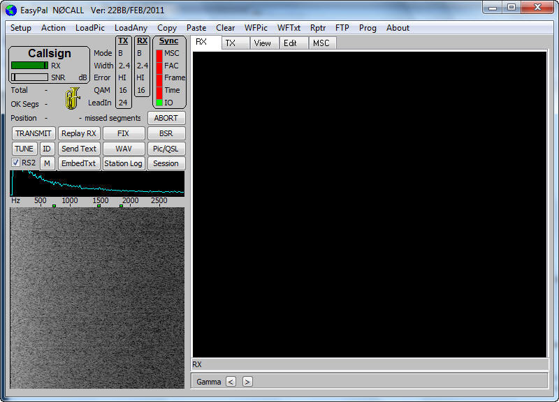

I've tuned in the last couple mornings but propagation has been rather poor lately. On one of the stronger stations heard (Virginia), I can get all the sync lights except the MSC. I haven't seen a pic yet. Running easypal in the "Basic" mode. Is there any setting that I need to change in the software? Other than the soundcard, I've left the settings "stock".

EASYPAL is not a low power mode, the Va station is QRO @ 1500 watts, so it takes a good signal to get a lock onto.
a couple of pointers,..... the SNR box has a "slider" that turns from red to green while RXing, don't allow it to get larger than 1/3 to 1/2 the way extended,... it will OVERDRIVE your sound card. (turn down the Mic in/LINE in as required)
also, above the waterfall there are 3 green "TIC" marks at about 750, 1500, and 1750 Hz. when you are RX ing, there will be 3 verticle lines in the waterfall, adjust your RX freq as necessary to place the verticle line directly under the green TIC mark.
other than that, there really isn't much else to do to get it to RX.

Thanks for the tips with using Easypal, Road Squawker. I see it boils down to watching the audio input level and setting the receiver frequency "dead on" with the "Tics". I'm going to give it a try again tomorrow morning... hope conditions co-operate.
You mentioned the need for a good signal level for this mode. The lack of signal is probably the cause most of my difficulty. I wish propagation would pick up. Even the QRO Virginia station was only peaking about an S-4 here most of the time (I'm in the midwest). The others in the group barely moved the S-meter.
