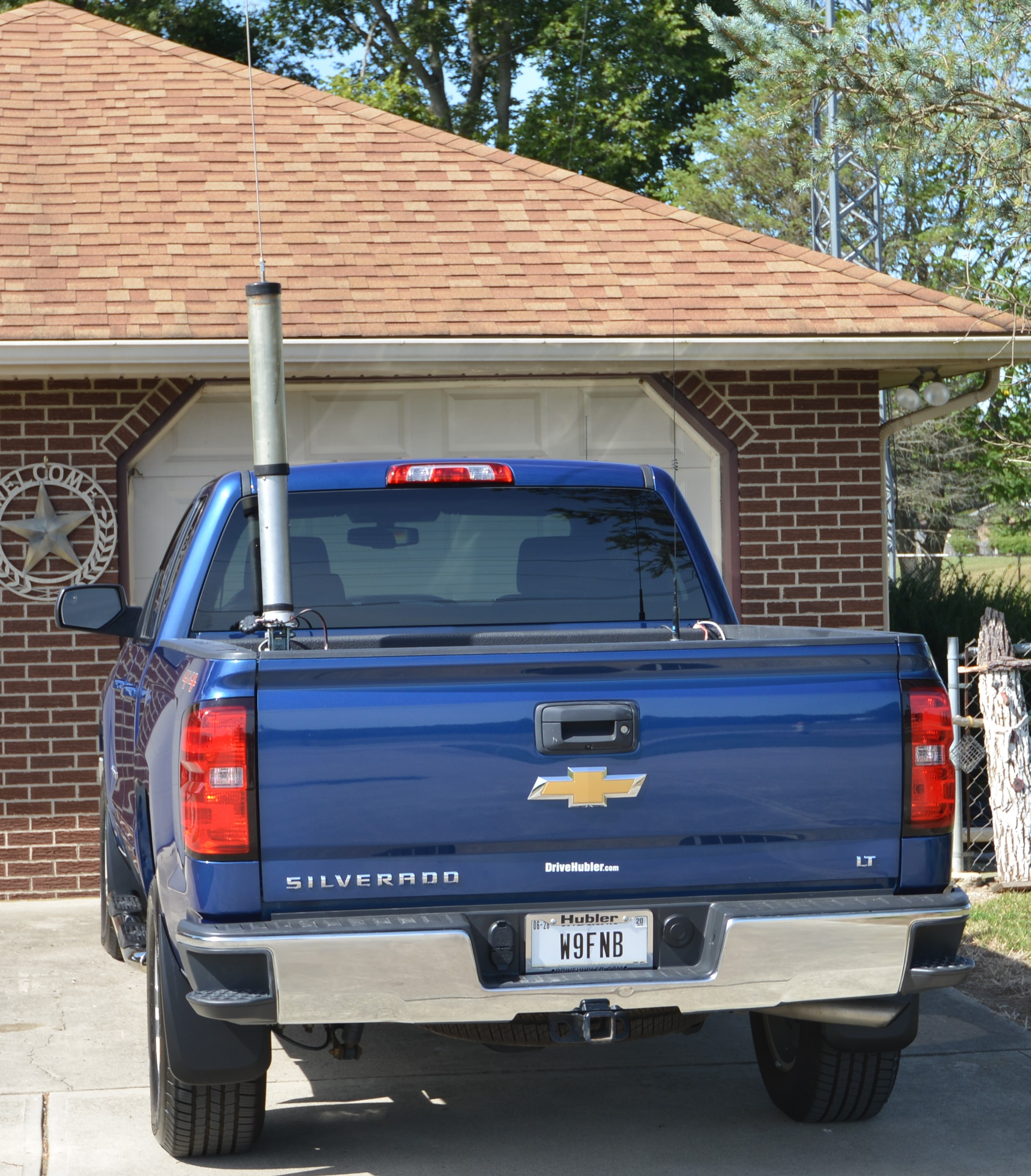

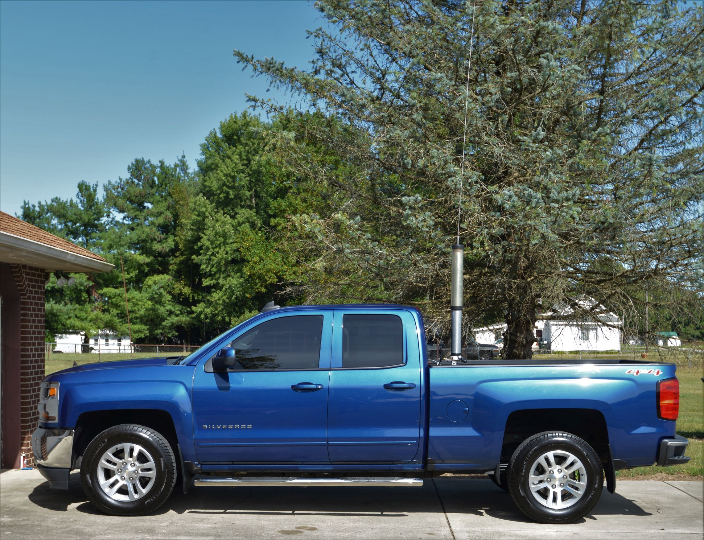

Brett: I ran a Yaesu ATAS-120 mobile for couple years they do work...Best config using the ATAS-120 for me was when the entire antenna was above the cab , plus I lengthen the steel whip to abt twice the original length. I found the antenna on 40 meters struggled to reach a real Omni type pattern when mounted at bed height or less, otherwise they were highly directional off the corners of the vehicle when Center mounted.
I did enjoy running the antenna on 20m and above, it preformed very nicely in above configuration.
All the Best
Gary/W9FNB
PS: I change to my pics above because the ATAS-120 barely handles a 100 w radio...seen several ops burn them up using the KWD 200w HX radios...
