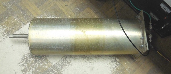

How about 1 of these single 'cavity' for RX and 1 for TX of these single 8" cavities??
http://rover.ebay.com/rover/1/711-5...0001&campid=5336136228&icep_item=301909457655
For use on 90-150mhz, with N connectors..
Seller (who is a HAM) says it should add 25db isolation to the RX side, and using a 2nd one on the TX would help also..
He is willing to give me a pkg price for both..
I planned on using my LDF4-50A 1/2" Heliax for the TX, and LMR400 for the RX side, I have RG213 for the 'jumper' from radio to whatever 'filter' I may use...
Keep in mind each radio will have its own power supply and antenna, on separate ends of the house. The coaxial run for antennas won't be long.
I didn't run Conner's numbers but they sound about right so if you need an additional 107 dB of isolation why are you thinking about using something that offers only 25 dB? I have NEVER seen a single cavity filter offer anything remotely near what is required for isolation. I had a commercial repeater that had eight such cavity filters to achieve the required isolation however it did use the same antenna for RX as it did TX. Repeater building is not for the newcomer and there is more to it than most people think. IIRC there is/was a book called The Repeater Builders Handbook that had a wealth of info about how to design and build a repeater. In any event you are going to need several cavity filters on the receiver AND transmitter to ensure that therer is only one desired TX frequency making it's way to the antenna and that the receiver has enough rejection of that frequency so as to not de-sense during TX.
