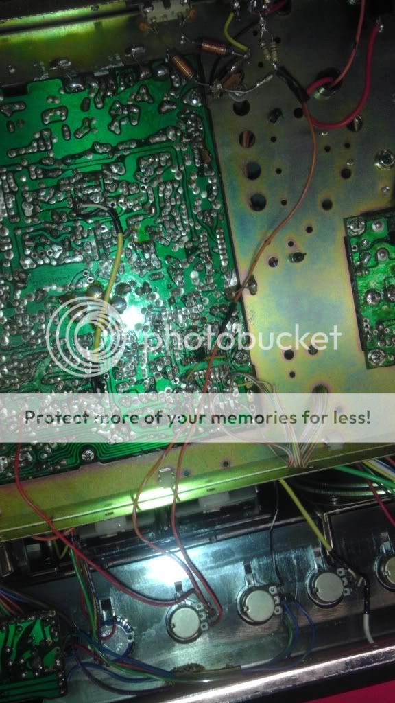

on the clarifier mod, the way they did it is kinda dumb.
remove the orange wire from those resistors and such and put it on pin 1 of the MB3756 voltage reg.
remove the red wire from PC board ground and insert a 3.3k resistor in series with it.
you will have to re-align the VCO offsets, but this should tame down the slide a bit.

that is 100% what I was thinking LOL
tapping off the 13.8V rail is not smart as it is not regulated as good as tapping off the MB3756 voltage reg.. if the voltage where to drift it would make the clarifier drift.... am I right?
that fixed it good I did not need to add the resistor or even realign it and it is much more manageable. it even put it back on the center slot LOL!

yeah he had 2 100ohm in parallel :headbang
here it is now after I fixed the wire
