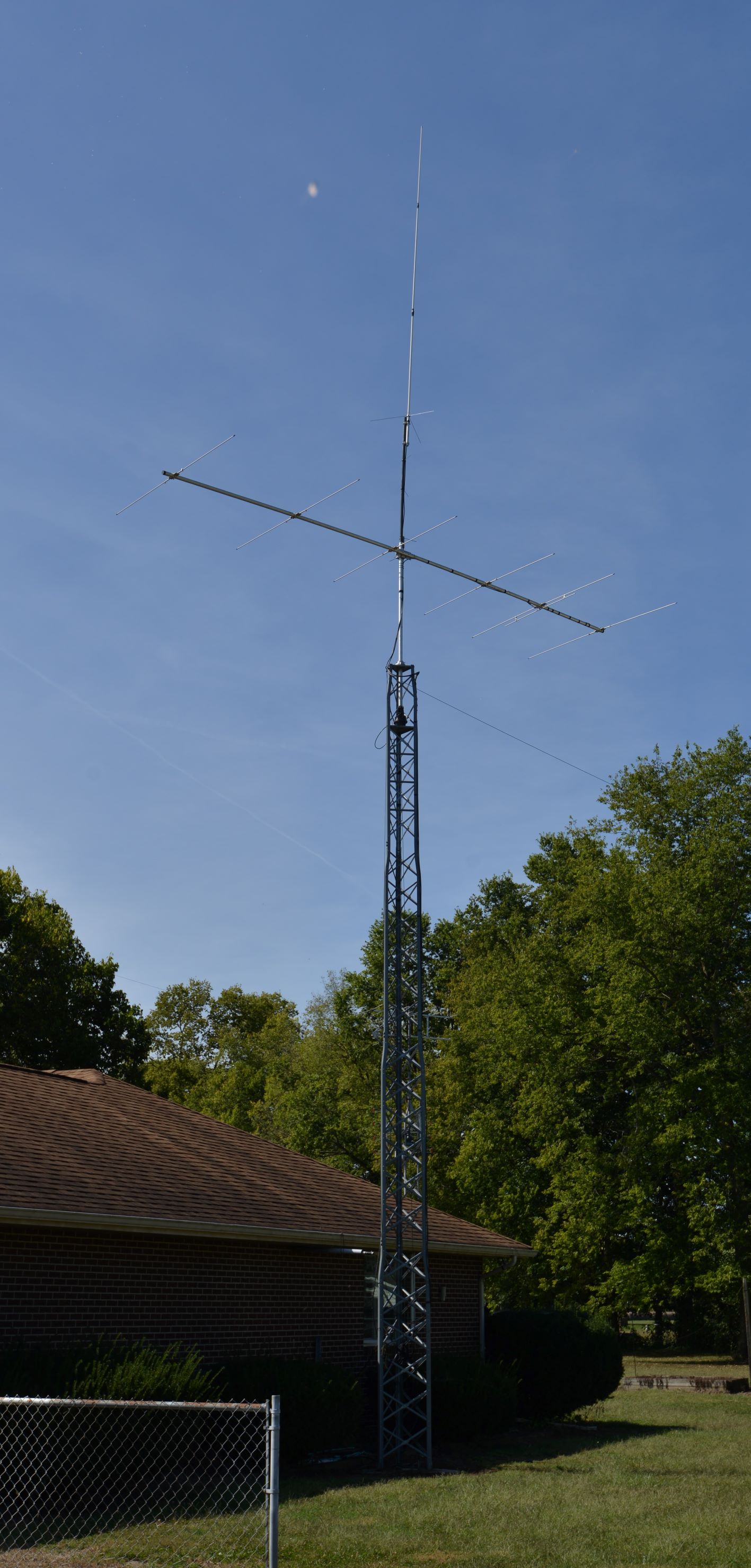

My 6m SSB/CW antenna presently...6 element Wide Space on 25ft boom...at about 40-45ft

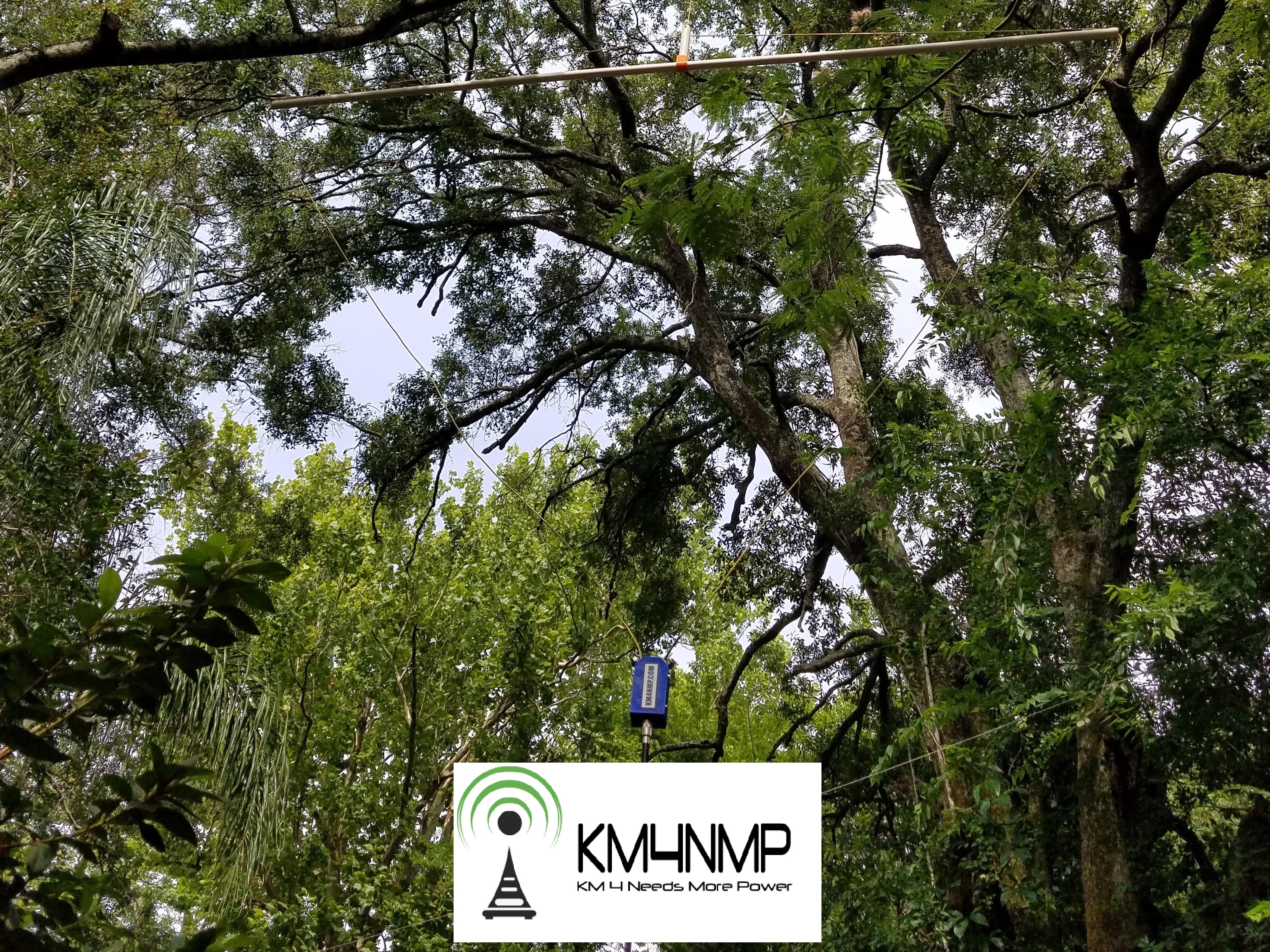

It's going to depend on what mode you are looking to operate with on 6m. I don't do FT-anything or FM on 6m, so the antennas I have built (a wire Moxon and a 3el Yagi) were designed for the SSB window of 50.100 to 50.200 or thereabouts.
I have learned, with a bunch of great help from BJ/Radionut, that 6m SSB is mainly weak signal work and an antenna with some additional gain over a dipole is almost required. During the rare and occasional Es openings lower gain beam antennas can work quite well, but I'm looking for more.
I want to be better able to join in "Meteor Scatter Mornings" from about 06:30 to 08:00 on 50.145 SSB, which I really enjoy. Great group of operators to talk with.
If you have local SSB traffic near you you may not need as much antenna. I hope you get on 6m, SSB needs operators since a huge portion have defected to digital only.
