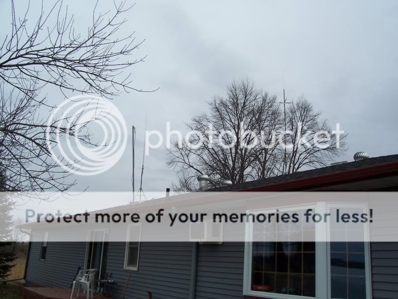

OK here is a pick of my roof......The 2m is on the north side and i removed the Maldol and put the gray pipe with balun on that tripod....Cleaned up the roof abit so now my option is mounting a 3rd 3ft tripod between the two already there and either put a vertical on a 6ft pole with a loop mounted under it running two coax cables OR would i be better off mounting a 6m yagi on the tripod with a 6ft pole and just run one coax with power and have 6m coverd with just a yagi.The tripod would be mounted right between the two wirrly birds..
A50-3S yagi would work right......
If there are no repeaters around me a vertical will not work right so it would need to be a OA-50 or a yagi right.....
