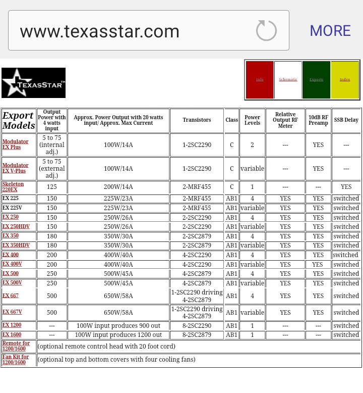

I own a 955 Stryker and would not consider ANYTHING smaller than a 4 transistor 2879 comp type amp to run behind it. I DEFINITELY WOULD NOT !!! run that TS 400 with your radio . Texas Star reccomends the MAX input to that amp be 4 watts carrier and 20 watts max PEP drive. This is listed on the Texas Star webpage FYI . 20180416_115300.png
