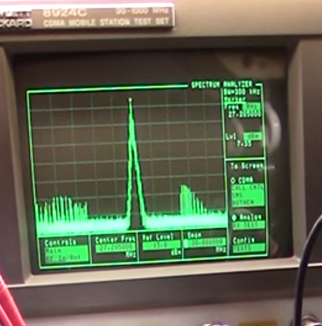

I'd run a 3-500z or an 8877 behind it....if mobile a 6 pill. With all the hack job builders trying to maximize profits these days I have no brand recommendation. Definitely put a low pass filter between that thing and any amplifier that's worth money.
Reactions: rabbiporkchop
That low pass will at least clean up half the problem. Bandpass would be better though.
Probably would be better to have a band pass filter. The 955 I had was a turd with spurious emission right out of the box. I fixed mine by improving shielding inside the rig but after it was all said and done my old truck has a cobra 29 in it again.
