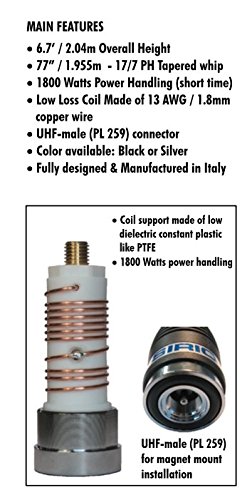

I am a bit puzzled ..the Sirio Megawatt 4000 is a 11m mobile antenna ..its 6feet 6inch long and base loaded ..however, Sirio gives it out as a 7/8 wave ,, well i know a 1/4 wave don't need a matching device and a 7/8 wave will need one ..but the Sirio don't need one which would lead me to believe its at least pretending to be a 1/4 wave ...so how do Sirio call it a 7/8 wave and what is it really ??..if i had to guess i would say its a 1/4 wave that's been shortened and had a coil/inductor added to compensate the missing length but is it not still a 1/4 wave as it don't need a matching device
It is a well performing antenna (all the 2 meter long Sirio's are fine, I have a 4000 Hi Power here) However I would be surprised if the coil + whip = 9.6m of wire. I have seen a cross section of the coils in these length Sirio antennas and I would be surprised if the coil was more than 3/4 a meter straightened. It's a reduced 1/4 wave. I would be inclined to go for the 4000 Hi Power or P2000 Trucker if you can stretch the budget just a little. (Coil copper is thicker @2.5mm instead of 1.8mm and as such will likely be slightly less lossy)
edit to add : this is for the Sirio Megawatt 4000, the 4000 Hi Power is a little thicker coil below....
SIRIO sell 1/4wave antennas as 5/8 & 7/8, 7/8 just has less wire more whip,
i used to mod sirio to take longer stiffer whips from valor & avanti by removing a turn from the top of the coil, you will find less than 1/2wave of conductor in any of them,
they are not alone in the mickeymouse wavelength claims, most european brands do it.

I own Megawatt 4000 and it works fine with tuned coil.
With original coil swr readings was not good anywhere.
Measured with antenna analyzer.
Same issue with 5000.
