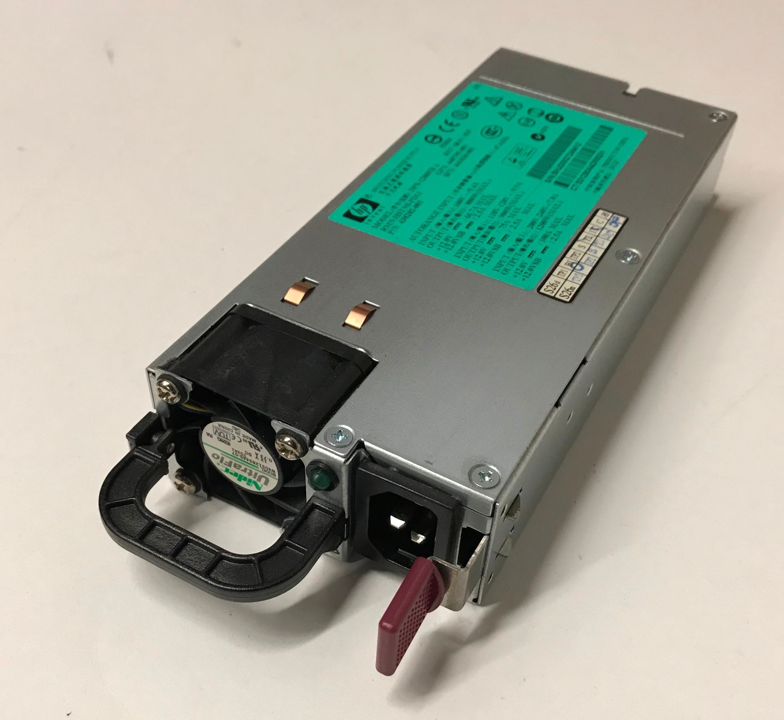

How about a 75A HP 1200W Power Supply (DPS-1200FB) for $20USD? I picked up a couple locally last month for that price.
These are excellent, I run one as well. Rock solid on voltage stability and almost silent. Only drawback is the most I can get out if it is 13v.
Very easy to convert
Reactions: binrat
I have a Dell rated at 100 amps or so I picked up for a song. Supposed to be able to get 13.4V easily, and higher with the right mods.
The one above looks to be 75 amps, from what I can see if the label.
