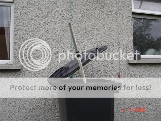

I ran the A99 for years and had good results on 10/11/15/14/16 :whistle: meters and was please with it.Sure there are better antennas but the A99 did what I needed to do.
In hindsight I probably should have used George's mounting method:
