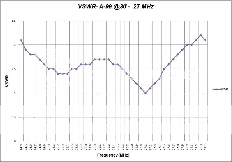

Well Oldtimer,
Rather than rely on my memory (which is suspect already!) I thought I’d take a few minutes and actually measure what my A-99 looks like. First thing, it’s actually fed with 100’ of LMR-400, not 75’—it’s my yagi that’s fed with 75’, sorry for the error. Here’s what I measured with my MFJ-259, measured at my operating position through a 10’ jumper into a switch:
(24.5 appears twice because I had to round the numbers off to one decimal place so the chart wouldn't be so cluttered. The 2:1 point was 24.518 MHz.)
Not bad, really. I remember now during my testing that I tried to shift the whole thing upward a few hundred KHz to get more of 10m while still getting 12m, but that just did not happen. As I recall, the tuning in its final position, 30 feet in the air (the bottom of the antenna) was not much different from the testing position at 15 feet.
So, the 2:1 VSWR bandwidth on my A-99 as it stands is 3.52 MHz—which ain’t too shabby. The 2:1 bandwidth of the little ground plane was 4.05 MHz. So while it was better in that regard, it wasn’t all that much better, though I think I could have adjusted it to cover 12 through 10 if I’d been serious about it.

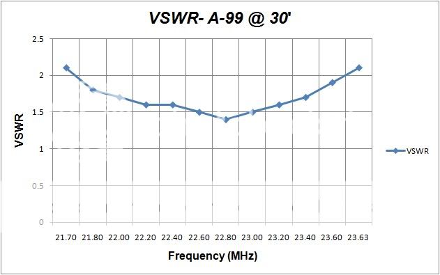

Here are a couple of interesting measurements:
These fall just outside the amateur bands of course, and I see several moments of low VSWR in the VHF spectrum (not 6 or 2 meters, dang it…)
I’m curious to see what other folks are seeing from their A-99s, and whether this is typical (I'd guess it is).

Rick, here is my Autek VA1 and SWR Bandwidth Curves for my A99 at about 41' to the mount. Your curve looks pretty close to what I see too, except you're a lot lower in frequency.

Many thanks for posting your chart, Marconi. That is interesting, very similar curves. If I'd been able to move mine up 400 KHz, that would have been nice.
