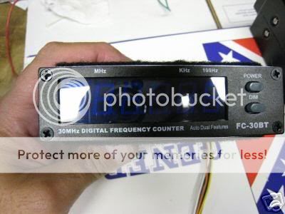

A little while ago I had my tech friend do me a favor and add some Extra Channels(frequencies) to my Cobra 148 GTL. He gave me a list of the channels but no clear indication of what frequency I'm actually tuned to. So I was considering adding a Frequency counter to my 148. These are the candidates I'm considering:
A FC30BT Blue Counter
Or A FC390-BL Blue counter

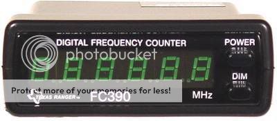

The first one FC30BT is in Blue And the second choice picture is in green; When in reality I'm looking to get the Blue version of it. I'm all about the BLUE theme
:D As you can see :
Now my question is Which of these two is the better choice?

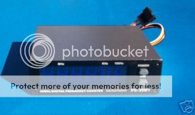

The other question I have is; In this picture they show that the connection is made via a six pin connection.
Is there a way to Add the male connection to the back of my radio which connects to the inside; so as to keep the quick disconnect capability?

I have a 148 that has a galaxy 6 digit freq counter that looks exactly like the texas star you posted. I have the female plug mounted on the back of the radio and the counter is velcroed to the case for easy removal if needed. seems to be a good :thumbup1:setup

Mounting a socket on the radio just depends on how much room there is inside the radio's back panel. Not enough room means changing to a smaller connector, maybe. And the whole thing just depends on how much you are capable of doing, or how much you're willing to throw at it ($$$).

This is one old thread. If there was one good thing you can possibley do for a older Grant or 148GTL with extra channels is a add a Ranger FC-390 to it :thumbup: very good 6 digit meters as well as having very good looks. Yes they work on both RX and TX ! These babies can be zeroed in very nicely. Easy install , they come with the female harness that gets wired to the board and then hangs out the back of the radios very nicely. For under 100 bucks for counter and install , these are truly a fabulous addition to these types of radios. Money well spent. :thumbup: And I think one would be even more proud to look at there radios there after. :thumbup:
