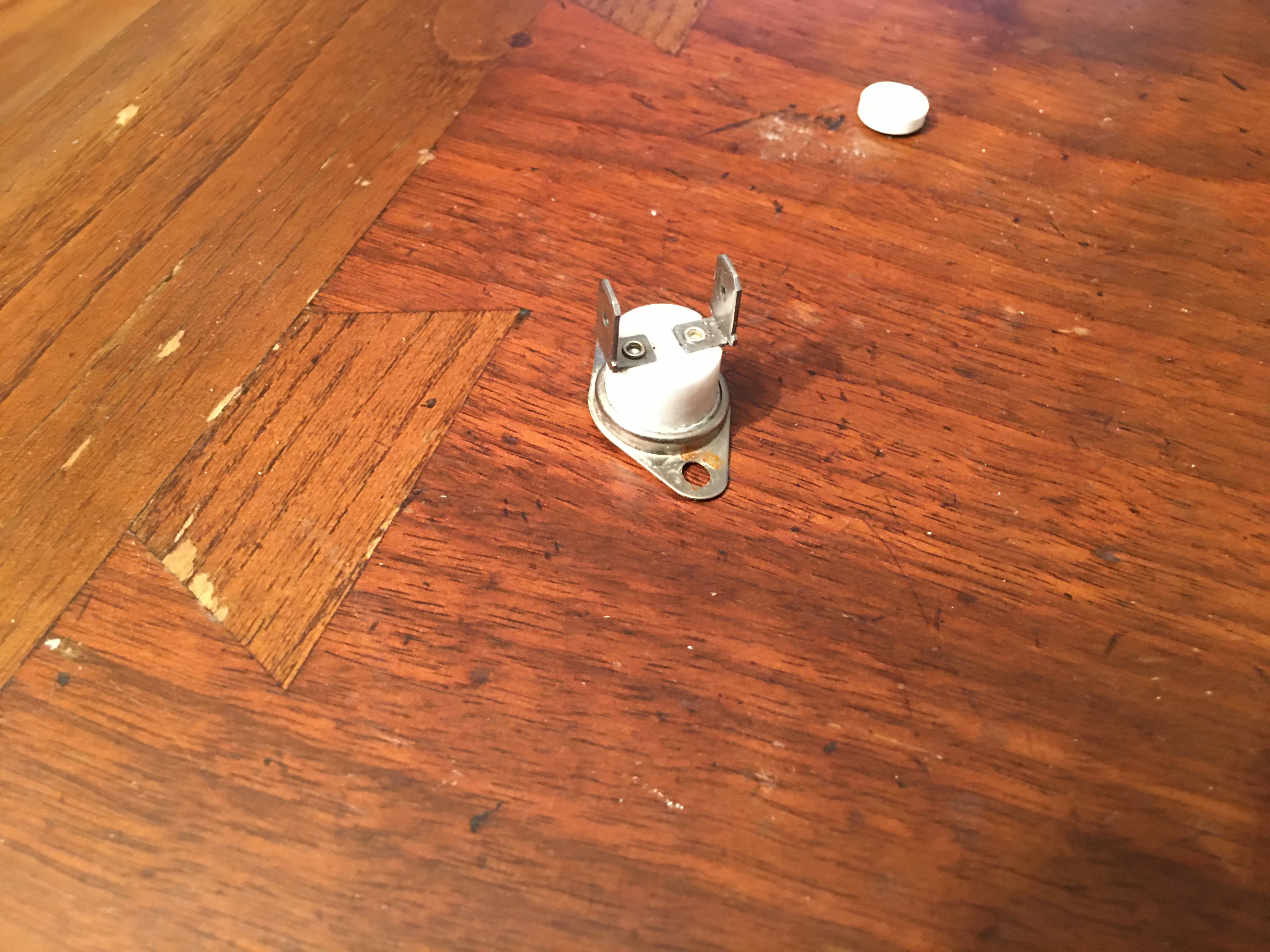

I don’t have as much electronics equip & tools as most Members but, it’s a lot. So when the relatively new Garment Steamer stops working, it looks funny if I can’t fix it. I need a thermal switch & all I need do is find one. Illegible Part # no help from Pur.

Mystery solved over Normally Closed vs Normally Open.
The Part marking convention is denoted by whether the terminals are Bent/Straight and by the color of the insulator: Bent foot w/ white insulator is Normally Open.
Straight foot w/ black insulator Normally Closed.
My problem was that the part # was worn away.
