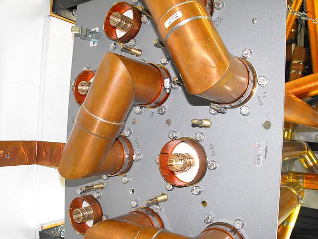

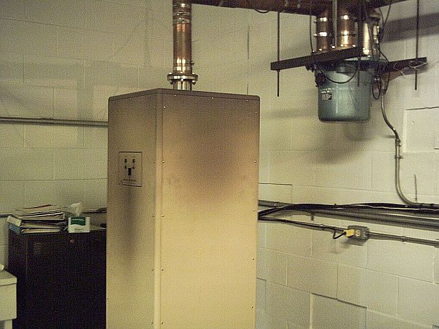

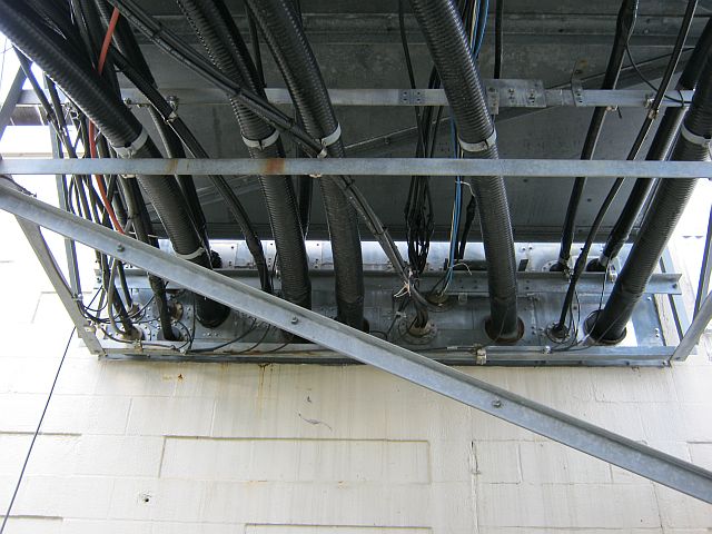

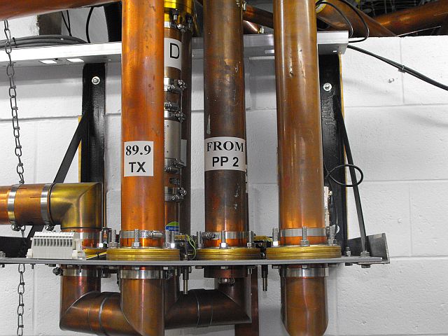

Here are a few pics of rigid line and patch panels at my work. The molten 25kW dummy load has a 3 inch line on top. In the pic of flexible lines the large ones are 5-inch Andrew HJ9-50.

Here's a picture of a 3-inch patch panel.
