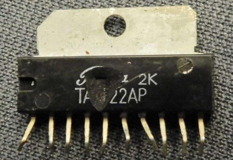

This Cobra 2000 came in with the story that a spare-bedroom tech had dropped his screwdriver into the radio.
With the power on.
There was a "SNAP!" and then no more receiver audio.
And no modulation on AM. Sideband transmit still worked.
As someone used to say "Well there's your problem!"
This tech's only response was "I guess the next one you want fixed will be free", as he shrugged and wondered what was wrong.
We also replaced the output capacitor. Got in the habit of doing that any time this chip is replaced. If it's shorted, the new chip will be blown before you can shut off the power.
Lucky for him, this was all that got damaged. New audio chip and cap, works just like it used to.
I found it a lot more amusing than the owner of the radio did.
Yep, they always blow on the side closest to the chassis too, so you don't see the hole until the part is out. Pretty simple to diagnose though when you have no tx or rx audio. It would just be easier if you could see the damage without working for it.

Knock on wood that I have not dropped a conductive tool inside yet. But I do have a YD1022 here that looks like your pic. Now if I can just find a replacement.... sheesh!
This page at A1 Telecom doesn't show a price, but they do list it.
You have to log in to get the price, but they are out of stock. Is that the unobtanium chip that repair shops are saying they can't fix if it's bad? If so, you may be out of luck unless you can find a donor radio.
