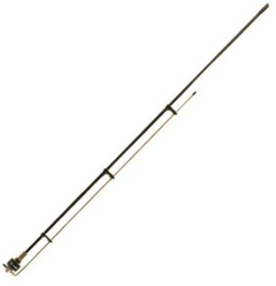

Recently picked up a DX-1600 AM/FM Antenna from Walcott Radio (also at Bob’s CB) marketed for Class 8 trucks.

But it’s time to get the most from any radio or type if one is going to be on the road. I’ll be mounting this on the passenger-side spot mirror “bird perch mount” and will have to make up some RG-58 coax with appropriate ends of a length to suit. (Base at 9’ above ground, top two-thirds will clear cab roof).
Didn’t expect the packaging recommendation above of how to orient.
So, your morning coffee question is, which orientation equates with “pointing towards”(?)
And why?
The longer (45”) Fiberglas whip is, “the resonating AM antenna”.
Advanced Ferro-Magnetic Design!
Two Antenna Systems in One!
ATTRACTS SIGNALS LIKE A MAGNET!!

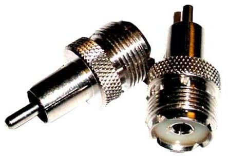

If you are setup to make pl239 connectors maybe it would be worth getting one of these Motorola/So239 adapters to put on the back of your radio?
That would make experimenting with coax simpler since I am sure you have tons of random cables with all your projects.

Ha! Many thanks for the adaptor advice! No, my brain hadn’t gotten around to it, but it’s the ideal way to get started. The big truck has everything else necessary.
